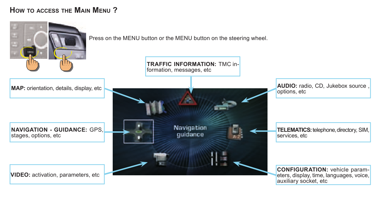

It doesn't display the trip info and I can't see the setting at 6 o'clock (think it's greyed out) so something is different compared to the images below.

Right, now I can see what you are referring to. On the X7 the trip info is displayed on the small central LCD screen in the instrument panel. That's why that option is not displayed on the RT4 on this model.
The RT4 was fitted to different vehicles (including Peugeots) that did not have the X7 display and so was displayed via the large multi function screen. As you can see from the RT4 Navidrive manual on the X7 below, the 6 o' clock option is not available.
It has probably been enabled using some third party utility - but that's something I won't cover here because of the way the data is routed and the possibility knock on effect this might have on other systems.

The thing is that Mel's X7 displays the trip info in the multifunction screen. Same year.

Likely that Mirascripts has been used on one to enable a feature that was never intended for the RT4 fitted on the early X7s to display this data as I mentioned before.
The earlier incarnation (RT3) used on the MK II C5 had this feature - because there was no separate display to show the information in question. The RT4 was fitted to a range of early PSA vehicles, each with different display options, hence why the feature was configurable.

Indeed, managed to enable that option with Mirascripts
