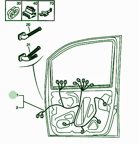

does anyone know if i can get away with swapping some parts from one to another, the donor car has lots of extras which i really would like on my other synergie.
i've decided to keep the one with less mileage and try and transfer some stuff over as it hindsight the car with less mileage is probably the better option for me as i intend to travel to southern italy in it.
the main things i would like from the donor car is the electric windows all over (INCLUDING THE REAR SIDE WINDOWS) i would probably intend to swap complete doors too with switch packs and interior trims as they are virtually identical. i really need to know if the wiring looms are compatible between both?
if someone out there can help with any suggestions that would be great.

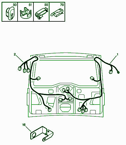

Ok, so based on the Vins you gave me, the harnesses in question are the same. I checked both of the following and they have the same part numbers.
Front Side Doors – Driver Harness: 6537SJ
Front Side Doors – Passenger Harness: 6537SG
Interior Wiring Harness: 6512X2

Rear Side Door Harness
Door Harness: 6534FR
Rear Taqilgate Harness: 6534GC
