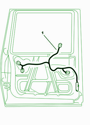

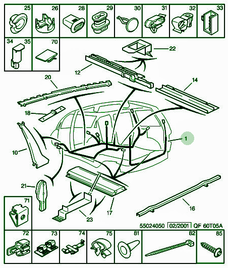

Ok, so based on the Vins you gave me, the harnesses in question are the same. I checked both of the following and they have the same part numbers.
Front Side Doors – Driver Harness: 6537SJ
Front Side Doors – Passenger Harness: 6537SG
Interior Wiring Harness: 6512X2
