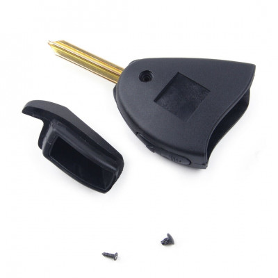

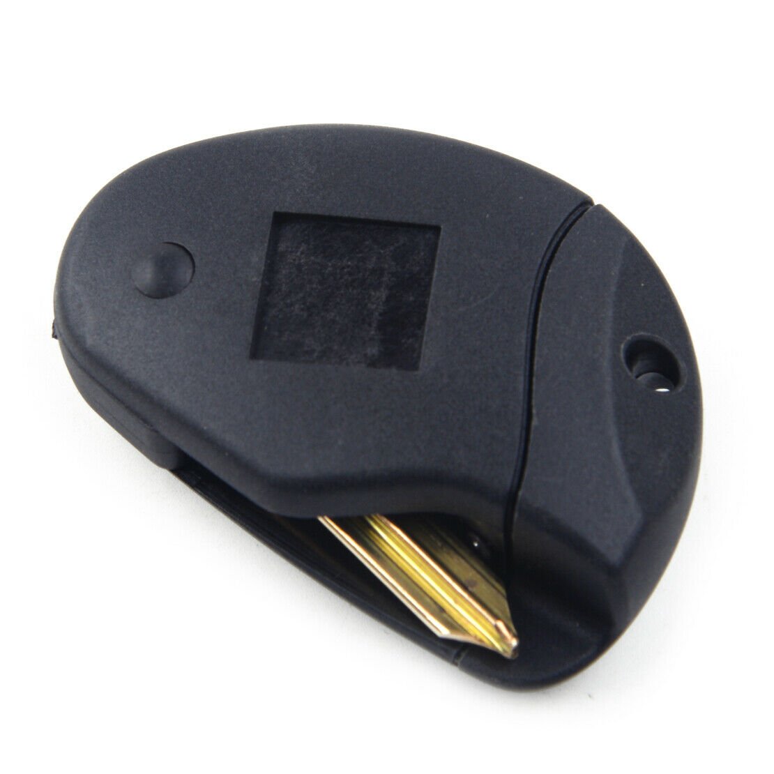

Does anyone know if the the transponders for the Citroen synergie clamshell type key are interchangeable?
I have found a few on eBay but the number on the sticker is different to mine they do however look identical.
I have attached the picture of mine and one I have found on eBay if anyone could advise before I get it wrong that would be great

The transponder chip is imbedded in the base of the keyblade on a synergie with this type of key, not on the remote PCB.

The bottom pic is a non remote key though.
The transponder chip is located in the base of the keyblade (part 4 on the diagram).

does anyone know if it's possible to just swop the keyblades and electrics out from my damaged key to a new shell?
item number on eBay :113331084522 it does look like on one of the pics that the centre pin is detachable to allow the key blade to pop out.
any help or advice once again greatly appreciated.

Yes you can 👍🏻
