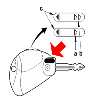

So the transponder is located in the fob as shown below:

The bottom pic is a non remote key though.
The transponder chip is located in the base of the keyblade (part 4 on the diagram).

It was just the key I choose from a different diagram - this should make it clearer.
