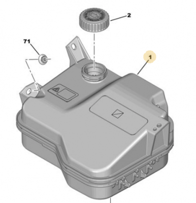

Re: 2005 C5 LDS
It’s not limited to the X7, the C6 also, but has also happened to earlier C5 models.
Part number is 4009S4 for the LDs tank - these are the same part on the MK IIs for all models. A new one from Citroen costs £92.71inc.VAT. But some second hand ones are nearly that price, plus you don't know the condition of a second hand one structurally. As you will need to drain and replace the LDS, you should consider that you can't re-use the LDS fluid so will need to replace that at the same time - so it is a risk if replacing with a second hand tank.

Re: 2005 C5 LDS
Confirmed as correct part number 4009S4:
