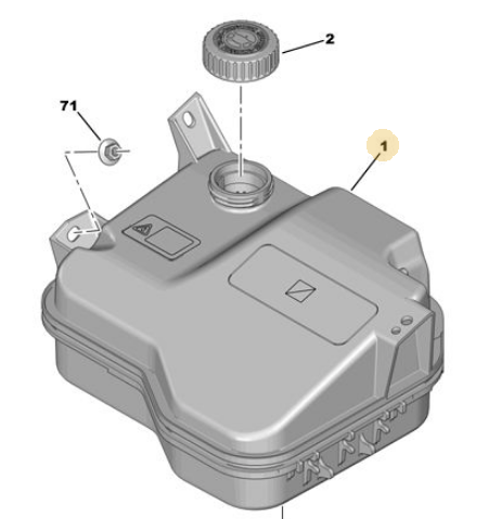

Part number is 4009S4 for the LDs tank - these are the same part on the MK IIs for all models. A new one from Citroen costs £92.71inc.VAT. But some second hand ones are nearly that price, plus you don't know the condition of a second hand one structurally. As you will need to drain and replace the LDS, you should consider that you can't re-use the LDS fluid so will need to replace that at the same time - so it is a risk if replacing with a second hand tank.

Confirmed as correct part number 4009S4:

The cap is sold separately, but one would hope it came with the cap for that price.
