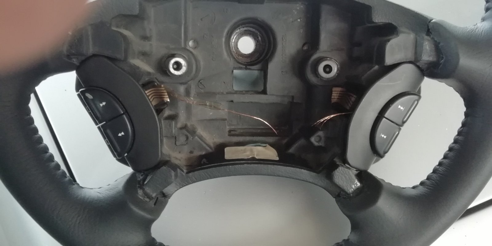

I have an XM, which at some point in it's checkered history has been fitted with a Xantia 2 wheel.
It's under refurbishment right now and one of the things I hope to do is connect the 8 (Yes 8!!) Control buttons to my about to be installed Pioneer Audio/CD/USB/Bluetooth Head Unit. I've got what I am assured is the correct connector kit BTW.
The wheel came off to go to the Upholsterer to have it recovered in Leather and I attach a couple of pics of the insides.
Seems to me that there are bits missing!
Can anyone oblige and show me what I should have inside there, and better yet tell me what I need to do to achieve my 'modest' objective?

The wiring ribbons for the radio switches have been cut off, there should be a small printed circuit board that they (and the horn switch wires) terminate on.
On the steering column there should be 2 rubber-covered ribbons to connect to the airbag (2 way) and the radio controls/horn (about 6 way) which go to the clock-spring rotary connector.
Depending on what radio and controls your XM was originally equipped with, it may not have the wiring for radio controls in the steering wheel.

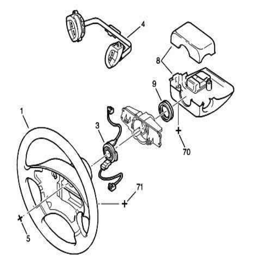

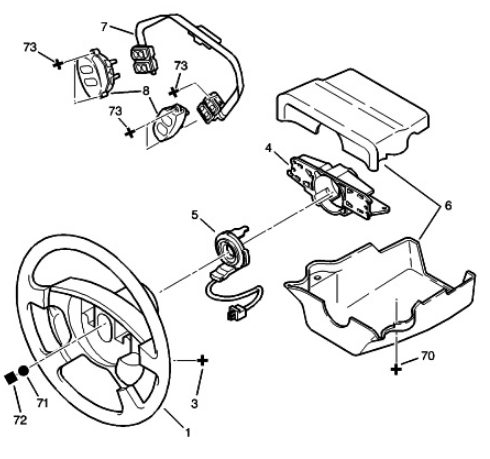

GiveMeABreak wrote: 19 Feb 2019, 10:58 They are similar but not the same according to parts:
Xantia S2 Steering Wheel XM S2 Steering Wheel Xantia MK II Steering Wheel.PNG XM S2 Steering Wheel.PNG

Hi Rex,
You could try to get hold an XM steering wheel, which should be complete with the audio switches, wiring and the small p.c.b.

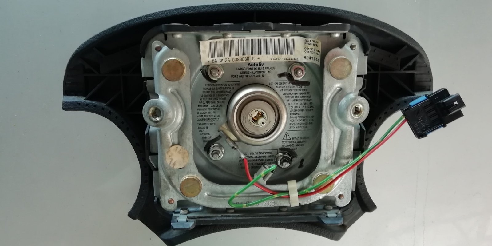

Do you have the multi-way connector for the steering wheel controls?
In this photo it is the black connector on the right. Your car may never have had one if it did not originally have steering wheel controls.
The orange connector second from right should be the connector for the air bag.
