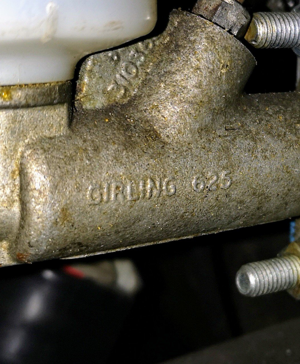

Having had a think about it further this morning I went to confirm the identification of my brake master cylinder so I could get either a service kit or new cylinder ordered.
Nice to see that the fluid level hasn't moved in the slightest since I've started driving it, I know there's no reason it should have, but it's still nice to see the fluid staying where it should be.
Yep, there's the number which I couldn't remember or find written down anywhere.
Doing a bit of digging around on the internet to see what I could find. When did the search function on everything become so utterly useless? Why when I type in "Girling 625 master cylinder service kit" are the first five items for Lockheed cylinders or totally different complete cylinders before anything starts to turn up that's useful?
Anyhow...eventually managed to track down some rebuild kits. They're a good bit more expensive than I'd expected...not far off the same price that genuine Girling cylinders seem to go for (£60 or thereabouts). Though there are a plethora of off brand ones for £20-30 out there. Though quite what sort of quality to expect at that point I'm not sure.
I did however decide to grab one. Basically because A: I've had gift money sitting in my Amazon account for about two years now so it's essentially free. B: Because it will at least let me prove the rest of the system behaves or not. If it does behave perfectly then I at least know that the MC is the issue...if I can't then make one good cylinder out of the two or am actually satisfied with the one from Amazon that turns up, I'll get a proper new Girling one ordered up. As the one I've ordered is essentially free it seemed worth a shot though.

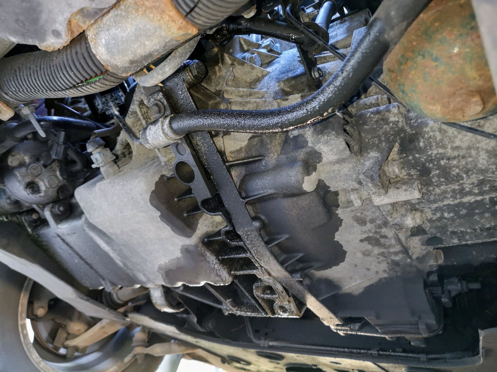

This has been a bit of an issue as long as I've had the car. The clutch works just fine, no judder, no slip no snatching. However the bite point is about an inch from the floor, which gets quite tiresome around town.
Not knowing for certain if there was any way to adjust the cable I figured it would just make sense to find it and have a poke around. I've managed to convince supposedly self adjusting cables to tension up better with a bit of violence before. Now, the engine bay in the Activa is somewhat "busy" to be honest. Nothing obvious there, but I figured it would likely be easy enough if I pulled the air cleaner out.
Hmm...nope. Still can't find it. Let's pull the rest of the air intake elbow and look closer.
Plenty of obvious cables for the gear change...no obvious clutch gubbins. How about taking a look underneath?
Nothing (aside from a minor LHM leak - one of the return line weeps slightly at the reservoir). It looks horrendous in the photo but she's never used a drop of oil, water or LHM and doesn't mark her territory.
Turns out I'm an utter idiot. The Activa in 2.0T form (all we got in the UK) has the ML5 gearbox...which means hydraulic clutch! That had never even crossed my mind...once that gem of information crossed my mind the fact that there must be a fluid reservoir for it (unless it uses LHM...though apparently not) also joined the party. A tip from a fellow Citroen enthusiast on here has me now knowing where to look. Turns out I'd looked at it a hundred times and never given it a second thought.
I'd always assumed that was the interia switch as that's what it looks like.
So I'll check it there's fluid in it in the morning and see about bleeding it. Fingers crossed that might help a bit as there's no adjustment possible and it's been bugging me this last week (it's the van's fault as the clutch in that is lovely now).

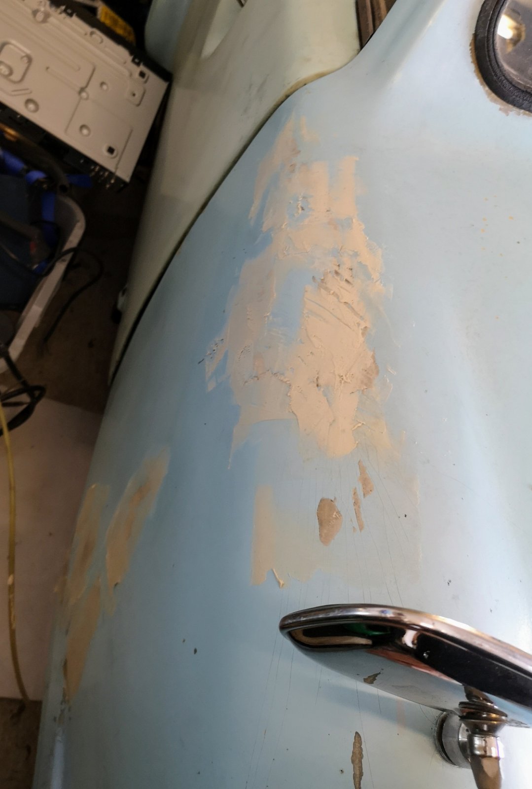

Invacar has been seeing a bit more cosmetic work continue. Bit more filler has been thrown into the equation to help smooth things down before I throw some more paint at it.
Small (but to my mind disproportionately annoying) chunk missing from the offside door.
Top of the nearside front wing where it's had a knock at some point. I'd already applied matting and resin from behind the panel.
Worst panel on the car though was the front service cover, so we'll see how that looks after some sanding action.
Will just be a quick sand and splash tomorrow morning which will make things look a little bit more presentable.

Somewhere? Jim has an involved description of clutch bleeding on a Xantia. It could even have been yours.
There is no bleed procedure as there is no bleed nipple. Jim fitted one to the slave cylinder but as I recall it still isn't an easy thing to do.
I did wonder at the time if it would be possible to fit a C5 slave cylinder as they do have a bleed nipple, I noticed that when I changes my reversing light switch.
My sinker had an hydraulic clutch. I was mystified as to why there were two master cylinders but the one on the right turned out to be the alarm kill switch

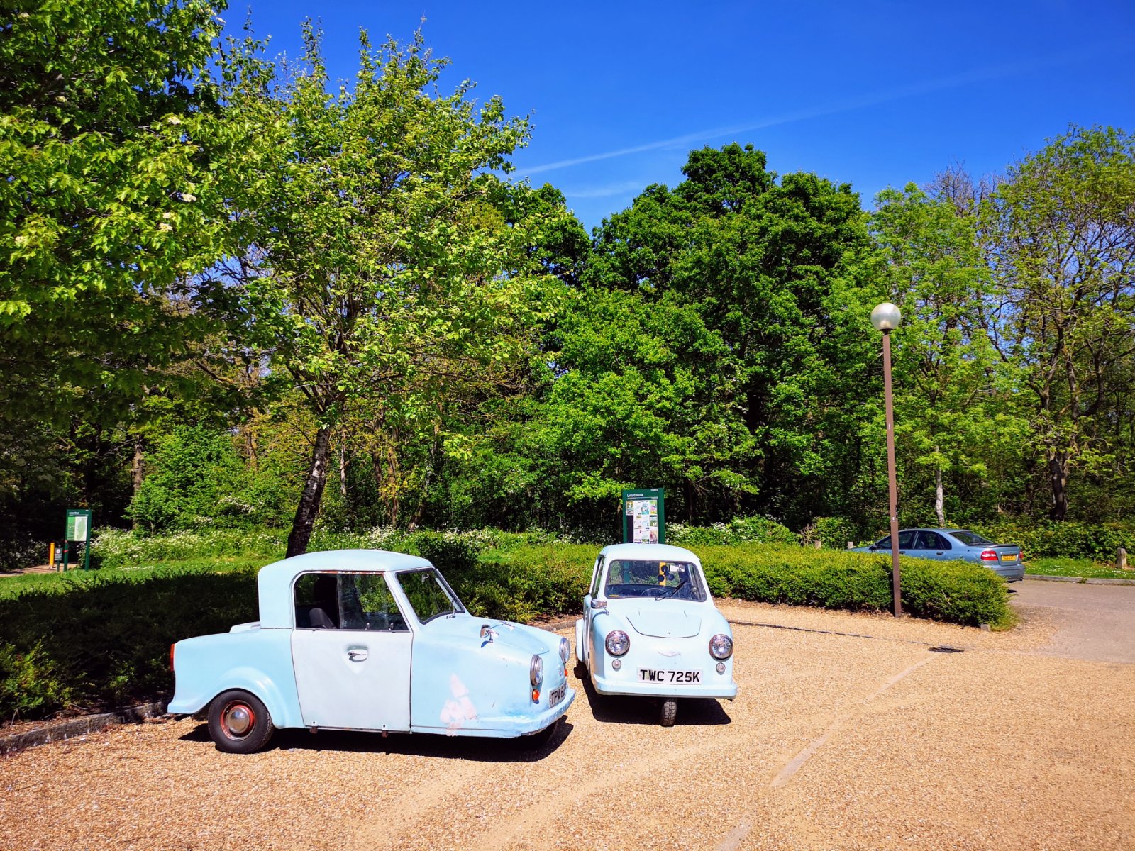

Soon after I was done with that my guest arrived and we went out for our little drive, stopping at a local from park which has some nice greenery in the background so is a good place to take car photos.
That was quite a fun afternoon. Yes, we did get some properly confused looks when we were out driving in convoy.
This was going to be the first time they'd been in one spot while both were roadworthy, so obviously we wanted to get a few photos of them together, have a little drive out in convoy etc.

So I suddenly found myself with a couple of hours to kill. Figured it was time to throw some more filler at TPA. ????
?Still a bunch more sanding to do, but we're getting somewhere. ?
Nearside? quarter loo?king almost sm?ooth. ?
The huge gouges????? on th?e nose have been smoothed out. I felt this was quite important given how prominent the area is. ?
Bonnet hinge area??? is almost resembling flat again and I've built up the corner of the bonnet which I'd clearly missed on the ?first pass. ?
Finally got the??? hole in the roo?f filled. Meant the duct tape there can finally ?go?.
This corner is actually????? starting to look passable. This is as far as I got with the sander. Even with the dust extraction set up the? process still makes a godawful mess! ???
The biggest? pits around the rear of the car have been filled, though some further work will definitely be needed there - running out of filler meant I couldn't go much further today!
The chunk????? taken out of this wheel arch has also been patched up.
Will spend a bi?t more time with the sander then throw some paint at it. May have a shot at remodelling my ?original work on the offside front corner first though as the state of that makes my skin crawl... ?
At least matching the original level of f?in?i??sh on an Invacar isn't too strenuous compared to most vehicles, though even that's horribly time consuming! ?
