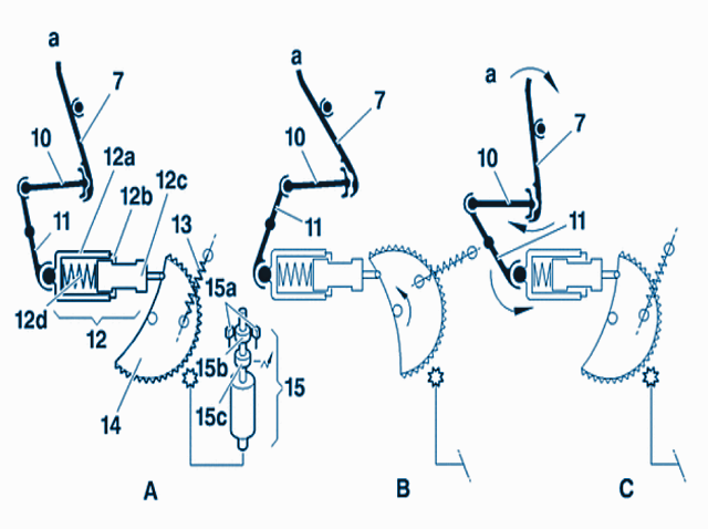

Some info on the system:
Simplified plan of clutch actuator.
A) Clutch closed.
B) Clutch open.
C) Clutch wear adjustment.
(a) clutch release bearing.
(7) Clutch fork.
(10) Piston rod.
(11) Rod.
(12) Clutch wear adjustment system.
(12a) Cover plate.
(12b) Locking system.
(12c) Piston.
(12d) Clutch mechanism retaining spring.
(13) Force compensator spring.
(14) Toothed quadrant.
(15) Electric motor.
(15a) Position sensor ("Hall effect" sensor).
(15b) Rotor (magnetic field).
(15c) Electric motor manifold.
The electric motor ( 15) is controlled electrically by the gearbox ECU.
The electric motor is not supplied by the gearbox ECU in order to hold the clutch in the open or closed position.
To pilot the clutch, the gearbox ECU uses the two position sensors ( 15a).
The sensors are located opposite a magnetised phonic wheel which is linked to the rotor of the electric motor.
The sensors provide a square signal for the gearbox ECU when the electric motor is turning.
Opening of the clutch (B)
Sequence of operations:
The declutch travel is the same whatever the state of clutch wear (20 mm approx.).
Closing of the clutch (A)
The gearbox ECU inverts the supply of the electric motor ( 15).
The toothed quadrant ( 14) resumes its initial position.
When the clutch is in the clutched position, the fork is no longer exerting a force on the wear adjustment system ( 12).
The wear adjustment system ( 12b) unlocks, the wear adjustment system can be compressed.
Clutch wear adjustment (C)
The wear adjustment system systematically locks as soon as the toothed wheel ( 14) is driven by the electric motor (15).
Clutch closed (clutched): the wear adjustment unlocks.
The spring ( 12d) allows a force to be exerted on the clutch bearing.
The clutch disc wear is compensated by the compression of the wear adjustment system ( 12).
As the clutch disc becomes worn :
At maximum when the clutch is new
At minimum when the clutch is worn
N.B. : It is not possible to carry out repairs on the wear adjustment system.
