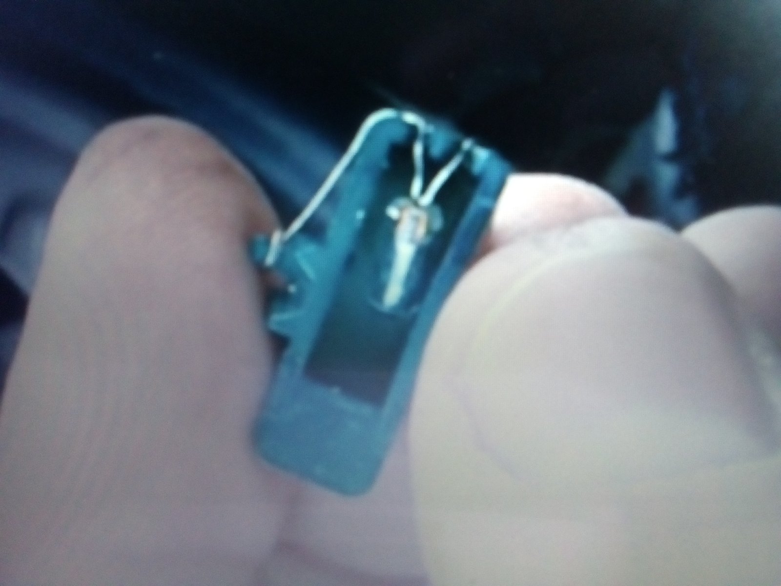

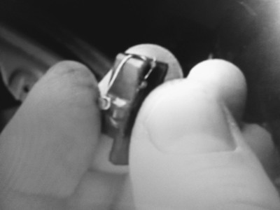

yes, Did open one I had bought online off ebay.
Trouble was this one was burnt out as well,it has 2 wires which wrap around inside the rocker switch..so looking to buy new,as buying second hand is just going to be hit and miss.Coudl go to my mates scrappy and check there I suppose.
finding a new one would be better.

An electronics supplier should be able to supply those.
They are usually 12-14v, 1.2W.
Lamp type is "T1 (or T1.5) wire ended".
