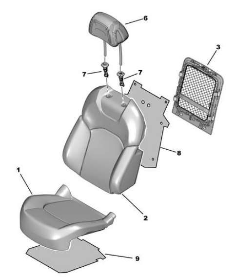

Yes, aware of it - but no longer available from Citroen new for your model Avi:
Only the whole cushion was available - item 1 below - but no longer supplied new.
Part 8863H4 for the Left
8863H5 for the Right.

As for the cushion, it is a complete unit - so you can maybe look for one of a used car - the part number is the right one for your colour upholstery trim.

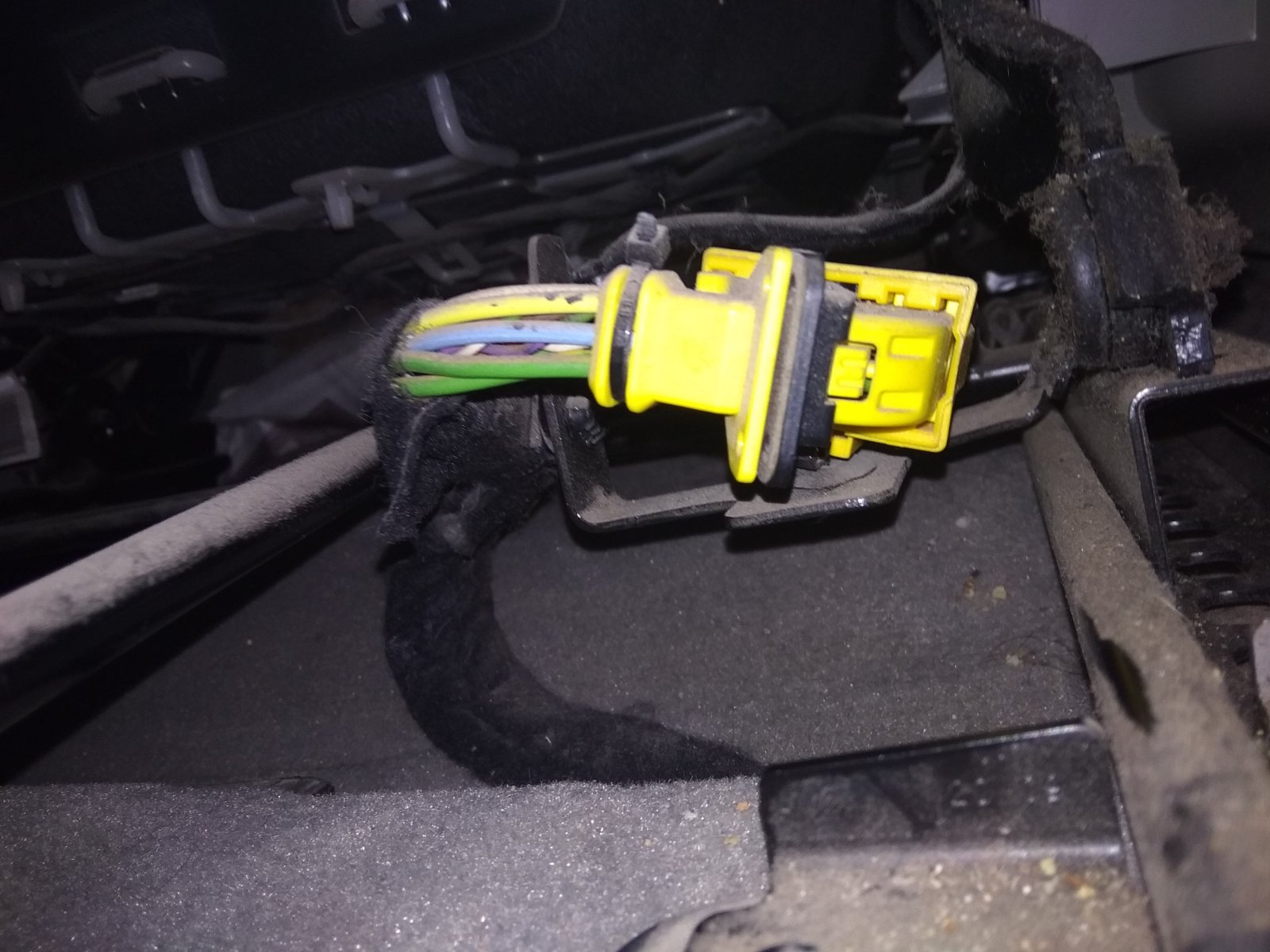

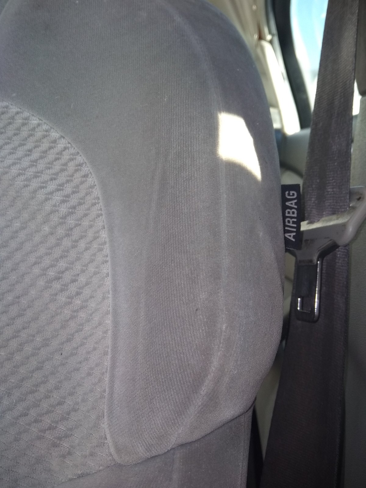

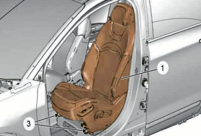

I think that the easiest way is to remove the whole seat from the vehicle and to take it to a repair shop. I guess that it's fixed to the floor by 4 screws in the railings, but my concern is with the yellow connector, which I assume, contain the control of the airbag located in the back left hand side of the seat (at least that is where the "airbag" label attached to it) and to the weight sensor in the bottom of the seat. so, what I would like to ask, if there is a procedure to disconnect it without causing the airbag to blow in my face? please be aware that all I've written are my assumption and it can be wrong, in that case, please correct me.
Avi
Avi
- x 6957
Re: Does seat foam padding exists as spare part - C5 x7
Those will be the seat belt pre-tensioner and seat airbag wiring Avi. You'll need to wait several minutes after opening the vehicle before disconnecting - but ideally the battery should be disconnected.

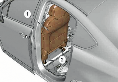

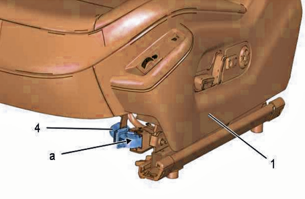

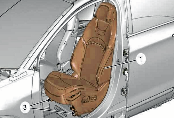

Procedure for 'Manual Seats'
Refitting
- Perform the following operations :
- Switch off the ignition
- Wait 3 minutes before disconnecting the battery
- Disconnect the ancillaries battery (Follow my disconnection Procedure here):
viewtopic.php?f=51&t=61997
N.B.: Tilt the front seat (1) rearwards (To make access to the connector easier).
- Proceed in the reverse order to removal.
- Apply thread lock to the bolts (2), (3).
- Tighten the bolts (2), (3) to 2,75 m.daN .
- Reconnect the ancillaries battery.
- Check that the electrical equipment is working correctly.

Thanx Marc. the procedure you've described is very comprehensive. what you're referring to as the "pre tensioner", is the device/ unit that senses when the seat is occupied and if the seat belt is unfastened produces the annoying sound and the warning?
Avi
Avi
- Posts: 14307
- x 3306
The pre-tensioner is the device that tightens the safety belt if an accident occurs.
- x 6957
Basically there are pyrotechnics in the seat belt units in which the belt fasteners click into. In a severe enough impact, the pre-tensioners fire, causing any slack in the seatbelt to be rapidly drawn back, effectively pulling the passenger back into the seat. This basically greatly reduces whiplash injuries as it helps prevent the body being momentarily thrown forward and backwards that causes the strain on the neck and head ('Whiplash' effect).atr wrote: 11 May 2019, 12:15 Thanx Marc. the procedure you've described is very comprehensive. what you're referring to as the "pre tensioner", is the device/ unit that senses when the seat is occupied and if the seat belt is unfastened produces the annoying sound and the warning?
Avi
They are also fitted to the rear seatbelts too, so be aware.
