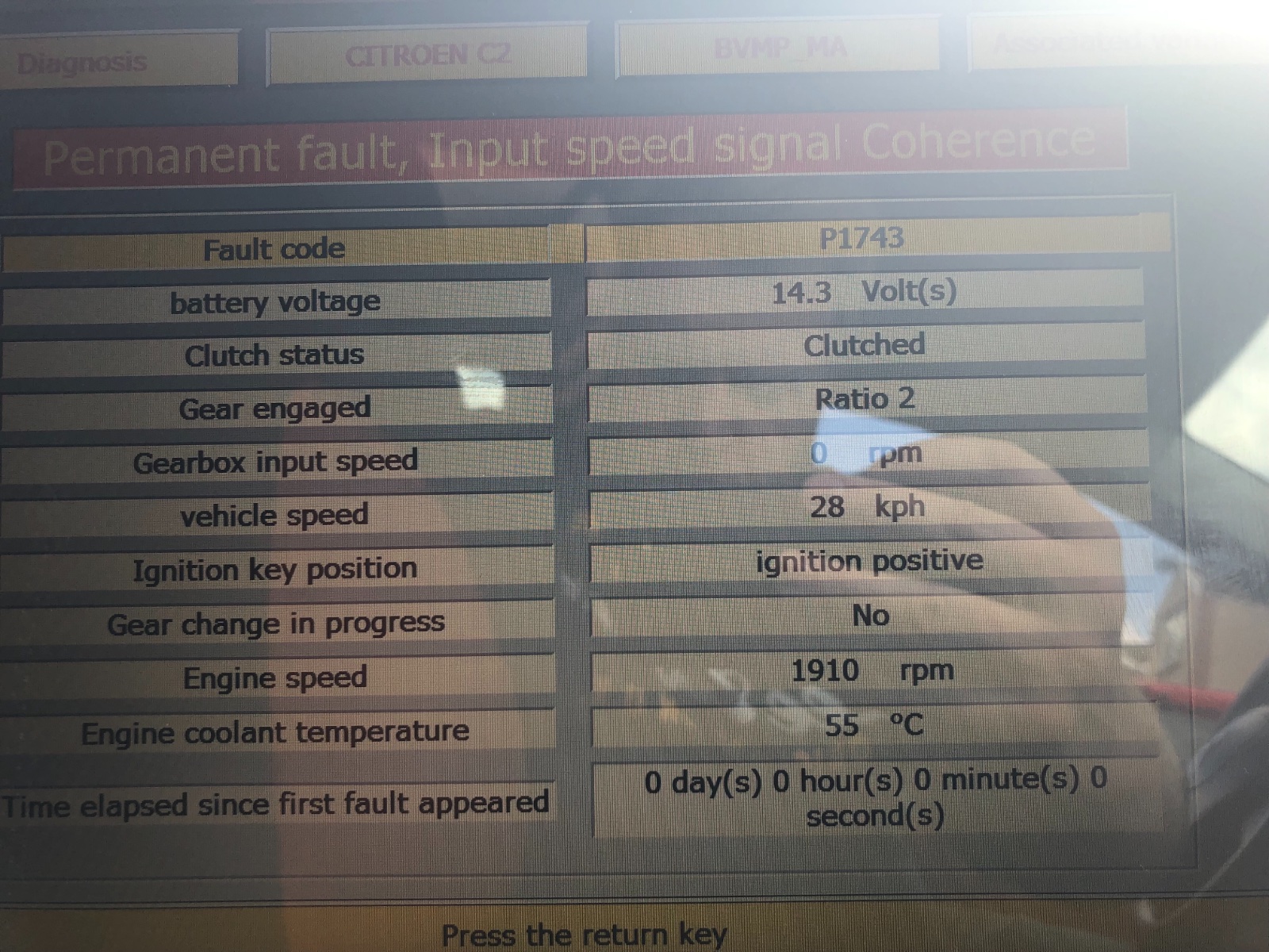

Google is sooo useless lately! I’ve got this new error now & I've no idea what it is! I’ve put an image up of the fault code in Lexia but I don’t really know where to go from here. If it helps I’m experiencing a similar issue to clutch slip but only when shifting gears. I’ll switch up a gear and the car will rev high but not bite immediately. It’s a 1.4 C2 Sensodrive

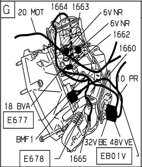

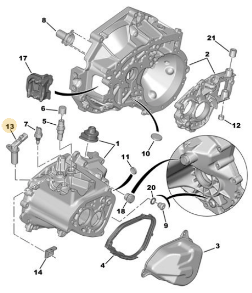

As for parts - I think it might be part 13 on the diagram below: On the electrical diagrams it is item 1662, which sort of resembles the location on this diagram:

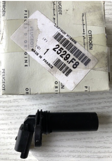

It could of course be the ECU or any of the other issues - but if it is the Gearbox Input Speed Sensor, and it is the part 13 on the first diagram, then that is part number 2529F8:

That's awesome thanks! I actually think it's number 7 based on the results I found searching for gearbox speed sensor Which look like these https://www.mister-auto.co.uk/sensor-sp ... eo/255304/

Actually 7 may be the reverse sensor....
- x 6955
Re: Help! Permanent fault, Input Speed Coherence P1743
7 is the reversing switch

Given it's reading an input speed of 0 when engine speed is 1910 and clutch engaged, it certainly appears to be suspect!

Thanks for the help with this, I’m gonna order the part you’ve suggested & pray it’s right & fixes the problem

OK so update on this problem, it was indeed the sensor... however it was because the clip that holds the cable on is perished so the cable had simply slipped off. That's sorted now! Took it for MOT today & it failed on sill rust
