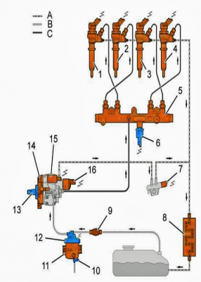

Ok, so here is the Siemens Fuel Supply System: The Induction Transfer Pump is incorporated within the High Pressure Fuel Pump.mikeyb1949 wrote: 10 May 2019, 20:47 I'm sorry Marc, I'm really confused now. So what is causing fuel to flow out of the priming bulb each time I switch the ignition on if there's no pump? Mike.
As Mike says - how long have you had it? If fuel is leaking from the priming pump, then it can only be coming from the fuel tank under higher pressure than normal (which it should not be), or pressure backflowing from somewhere....
| Reference | Designation |
| 1 to 4 | Diesel injectors (electrohydraulic) |
| 5 | Fuel high pressure common injection rail |
| 6 | High pressure fuel sensor |
| 7 | Fuel temperature sensor |
| 8 | Fuel cooler |
| 9 | Manual fuel primer pump |
| 10 | Water bleed screw + Bleed pipe |
| 11 | Fuel filter + water in fuel separator |
| 12 | Fuel heater (electrical) |
| 13 | high pressure fuel pump |
| 14 | Transfer pump (pre-supply) |
| 15 | Fuel flow actuator |
| 16 | High pressure fuel regulator on high pressure fuel pump |
A - Fuel tank return circuit
B - Low pressure fuel circuit (negative pressure)
C - High pressure fuel circuit
Special features:
- Fuel supply circuit with negative pressure: Induction by transfer pump (ITP) incorporated in the fuel high pressure pump (CRV)
- Fuel heating function integrated in the fuel filter cover
This is the Fuel Circuit Operating Diagram
(5) Fuel high pressure common injection rail.
(6) High pressure fuel sensor.
(13) high pressure fuel pump.
(14) Transfer pump (pre-supply) (ITP).
(15) Fuel flow actuator (VCV).
(16) High pressure fuel regulator on high pressure fuel pump (PCV).
(1) to (4) Diesel injectors.
" a" : Fuel inlet.
" b" : Return to fuel tank.
" c" : High pressure part of the fuel pump (HPP).
Transfer pump: Pressure limiter Calibration of the safety valve: 4 bars.
