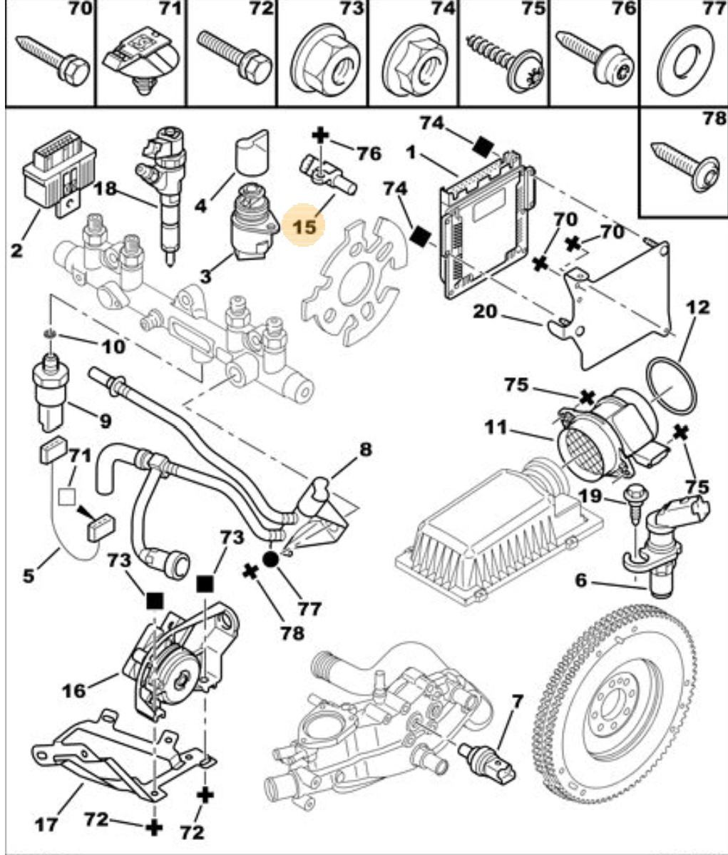

So you have the 2.0 HDi 90 with the DW10TD engine with a Bosch injection system, not Siemens.
You’ll find limits with generic code readers. Diagbox is the proprietary software with a Lexia VCI for PSA cars. Not for the feint hearted but you’ll also need patience and suitable laptop.
We can help with part numbers, but I would suggest you check here first before ordering as very often aftermarket suppliers are useless when it comes to supplying correct parts and ECP are one of the worst in my experience.
As for the parts, there is an engine speed sensor (3) and a camshaft position sensor (15).
Item 3 is part number: 616170
Item 15 is part number: 1920QN
These are PSA numbers that can be searched on for aftermarket equivalents or quoted to any Peugeot or Citroen dealer for order.

Bosch eh, well I only thought it was Siemens as engine bay didn’t look anything like picture in the Haynes book of lies.
Not sure why you are identifying those 2 parts as they’re not the crank or cam sensor ? What are they and do you think they may be the problem ?

Crank sensor is part number 6 by the flywheel and cam sensor is part number 15 next to its "target" plate. Part number 2 is the double relay fyi.

Sorry - I forgot the main part you wanted! Indeed, as PicassoDad says, part number 6 - Engine Speed Sensor, part number: 19208SMartinez wrote: 07 May 2019, 08:19 Bosch eh, well I only thought it was Siemens as engine bay didn’t look anything like picture in the Haynes book of lies.

on the diagram 15 is the camshaft sensor, 6 is the crank/engine speed sensor & 3 is the road speed sensor.
Agreed that this engine would not run if the crank sensor was faulty, It doesn't need the cam sensor signal to run but does need to see it to allow initial start up.
