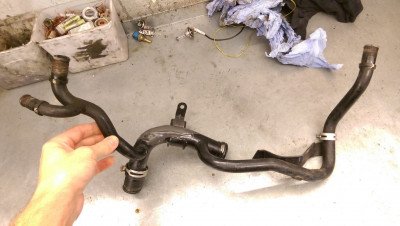

My wonderful Citroen C8 is destined for the scrapyard unless I can source a replacement part - 1341H2 pipe.
I am hoping that someone, somewhere might be able to help me to obtain one.
Why such a fuss over an old car?
Well, it is the first car I ever bought new since 2003. It has brought each of my newborn children home from the hospital and grown along with them, so I'm not ready to let it go without knowing that I've done everything possible.
The part looks like this

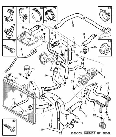

And is number 13 on this parts diagram

I reckon a collection of silicone hoses and joiners is the only way out of that....

Hello Richard!
Thank you so much for this. I recall you advising as such when I first had the problem with the pipe needing repair.
I did mentioned this solution to my car doctor and he said that high pressure will be carried with the pipe (hence it being made of metal).
I presume that the pipe is subjected to both high temperature and high pressure. Would the silicone hoses and joiners be appropriate for this job?
If so, I'll gladly head back to the garage to plead for this to be done.

It's widely used underbonnet, can't see why it wouldn't be any good. Here's an example https://www.viperperformance.co.uk/ - they may even be able to make a replacement one piece, worth asking.

Re: Please help! - Desperately seeking, not Susan, but 1341H2 (discontinued part) for Citroen C8
Hi Sid
Richards solution would in my opinion work up to a point. The silicon would be more than up to the job, remember the pressure in the water jacket is governed by the pressure cap (unless faulty) There might be variations in high flow areas but only a couple of pounds.
I think the reason for it being made of steel, is that if made of rubber the long runs might chafe against other components. Clearly steel holds its form and once secures in place will not move.
I would suggest that someone gets hold of the pipe and goes over it to ascertain where it is weak. It may only be in a couple of small areas. You have a couple of options then. 1.Weld them up if they are small or 2. Chop out a length of rotten pipe and replace with, you guessed it silicon hose. By retaining most of the steel, you retain the benefits of that material. You should only have to source straight silicon which comes in every size imaginable.

These folk (France) are showing stock for 1341H2, but check they actually have it...
If you need to fabricate one from scratch, you might be able to remake the metal part with copper (plumbing) pipe and elbows/tees, but braze the joints, or use high-silver plumbing solder.

Here's another in Germany

I wonder if that is something Pleiades could fabricate?

Dear Gents / Messieurs,
I am overwhelmed. Thank you so much for the helpful advice and suggestions, and the links to suppliers.
I shall try and get a new part, I think - my faithful C8 deserves the best!
I am just double-checking with my car doctor before ordering...
