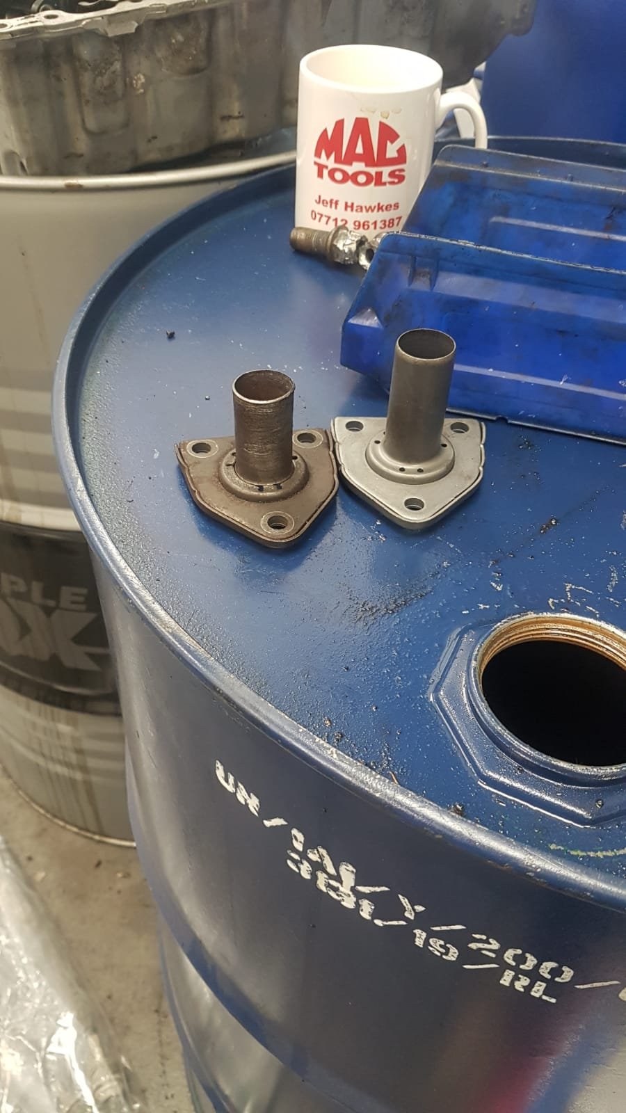

Hi got the car in for the clutch as guy been waiting on for ages saying not having time plus not rushed either
Got all the bits inc guide tube Borg and Beck HKD0006 now place doing says it's wrong one as too long?
Got onto place got parts from they was checking and say yes and info where getting from is wrong as says my engine is a DW10 and they say is something like DYGK or could it be DVGK? neither heard of! and they gave me a part number said this one will be right one? FEBI 46008 yet when i checked on line alternate listed parts was the B&B HDK0006 again.
Tried to source one Euro poop don't do them w*****s so spoke to GSF said have one mate picked it up and took it to place and is same as one i'd already got!
Was wondering if had worn it down when thrust race etc broke up and to me it looks a tad compressed also

Re: Xsara Picasso 2.0 HDI 2001
Part no:
2105 35
01
CLUTCH BUFFER GUIDE BUSH
This appears to be the only one used on the Xsara Pic and is used on loads of other Cits, but there is no mention of length. I would just fit the longer one, and as long as the box will mate up all good - if not, then drop the box back out and shorten it a bit.
2105 35
01

Hi many thanks for that part number does follow one i have from B&B also!
Could the tube get worn as thrust race parts break up? it did used to get stuck down a bit on release sometimes you needed to flick pedal up which we thought was spring on pedal box?
What would sometimes become notchy when using clutch and hard to push pedal down sometimes.
In pic does look a bit concertinaed.
