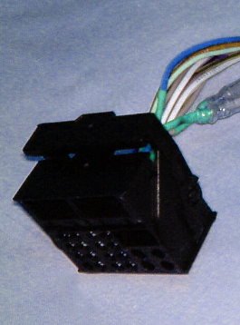

And Marc, thanks for the advice re connecting. TBH, I hadn’t done that before so I guess I’ve been lucky not to totally screw up my screen ! I suppose it’s obvious but I hadn’t realised there was a direct connection between the RT4 unit and the screen. When I look at the back of the RT4 will it be obvious which is the ‘quadlock’ ?

The Quadlock is the large connector block that holds several other connectors in one large unit:And Marc, thanks for the advice re connecting. TBH, I hadn’t done that before so I guess I’ve been lucky not to totally screw up my screen ! I suppose it’s obvious but I hadn’t realised there was a direct connection between the RT4 unit and the screen. When I look at the back of the RT4 will it be obvious which is the ‘quadlock’ ?
