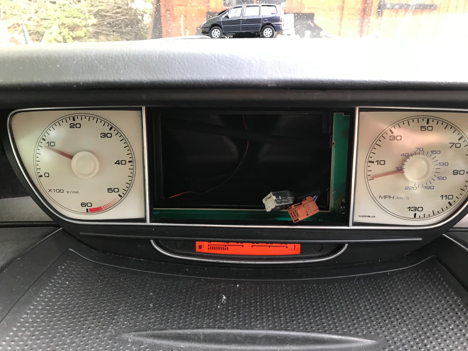

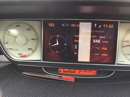

Hi,
I’m fairly new to this so please be gentle ! I hope a picture or a link is attached which should show the screen problem I have got on the RT4 system on my 2008 C8 2.2 HDi 173.
The 1” band appeared first a year or so ago and comes up intermittently with no obvious cause. It has progressively got worse and is now permanently black.
Has anybody else experienced this or have any ideas for a solution ?
All advice or comments would be gratefully received.

If you gently tap around the pod does it alter the band in any way? I'm wondering if an internal ribbon connector has come loose. Similar bands often happen on LCD monitors over time.

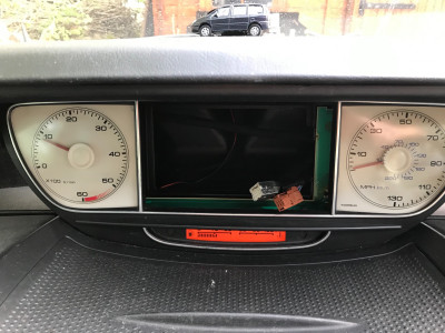

Thanks for your reply and suggestion however I did try that and it didn’t make any difference I’m afraid.
I’ve also removed the unit to check / clean the plug connectors but that also didn’t seem to have any effect unfortunately.

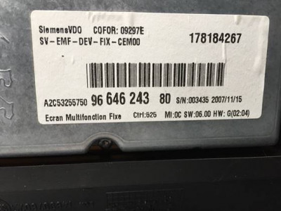

Do you have a photo of the screen's back side with some numbers so we can id it?

OK, great. So it is the low-res (DEV) screen.
Unfortunately the new matrix is around 350 USD, so the only option I can advise is get one complete screen second hand.

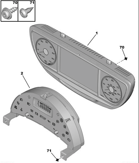

So you do have the RT4 system. Citroen parts don't sell the screen separately for the C8 - the screen is incorporated into the instrument cluster which comes as a complete unit. So the best thing I can think off is searching for a compatible RT4 screen from another PSA vehicle.

The instrument panel is still available from Citroen brand new (Part Number 6103E8) for the sum of: £2357.48! But that does include VAT
