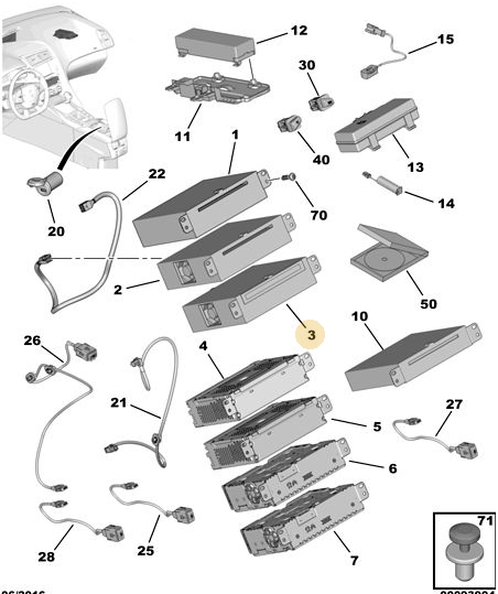

No that’s not the right one. There are about 30 different models depending on options for these units. I have your VIN number so I’ll have a quick look and see what the correct part is for you.
- x 6945
Re: DS5 intermittent working satnav/radio
Ok, so the part for the unit you want is: 1612068880
