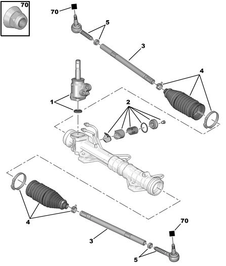

which part am i looking at replacing, i just cannot seem to understand the diagrams and corresponding parts :(
Vin number is VF7**************[VIN obfuscated, can be read by forum staff]

Its the play in the n/s inner steering joint that i need to replace, the joint itself has been flagged up on previous mot and i have been informed its not a steering rack replacement but when i go on servicebox it does not show me the joint just rods and gaiters
admiral51
Posts: 2655
Joined: 24 May 2007, 10:11
x 389
Re: MOT time again :)
Unread post by admiral51 »
The best i can get from service box is this part number 16 073 161 80
It is a ball joint and seems to be #5 on the diagrams for the VIN posted and appears to be the same part for both sides.
Just trying to get my head around the issue, was thinking that maybe if i get 1 done should i get both done as tracking needs to be reset afterwards.
The car is good, i know i will not get my money back in terms of resale being 14 years old just thinking ahead, cambelt etc done 3 years ago ( 20k since ) so i would like to keep it :)

Hi I think the part you're referring to is the inner tie rod or rack end similar to this
Posts: 42019
x 6955
If it's the Tie Rod End you need, then yes, there is a genuine part number and an equivalent cheaper version. As you say Colin, item 5 on the diagram.
381750 is the original OEM part: £39.88 inc. VAT
1607316180 is the cheaper alternative: £9.74 inc. VAT
