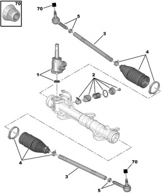

The best i can get from service box is this part number 16 073 161 80
It is a ball joint and seems to be #5 on the diagrams for the VIN posted and appears to be the same part for both sides.
Just trying to get my head around the issue, was thinking that maybe if i get 1 done should i get both done as tracking needs to be reset afterwards.
The car is good, i know i will not get my money back in terms of resale being 14 years old just thinking ahead, cambelt etc done 3 years ago ( 20k since ) so i would like to keep it :)

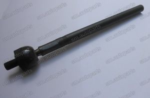

Hi I think the part you're referring to is the inner tie rod or rack end similar to this
x 6956
Re: MOT time again :)
If it's the Tie Rod End you need, then yes, there is a genuine part number and an equivalent cheaper version. As you say Colin, item 5 on the diagram.
381750 is the original OEM part: £39.88 inc. VAT
1607316180 is the cheaper alternative: £9.74 inc. VAT
