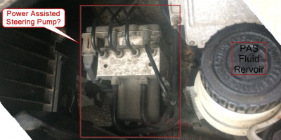

This is a C8 pump, I'm not familiar with the C8 but if it's located in the same place as on the C5 it's under the RH front wing forward of the under-wing plastic shield.
An electrical connection fault under there might be your problem.
https://www.ebay.co.uk/i/113531775041

No, that's your ABS Block!

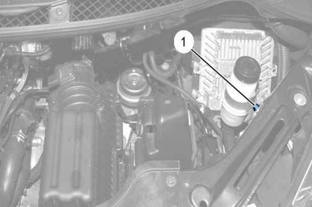

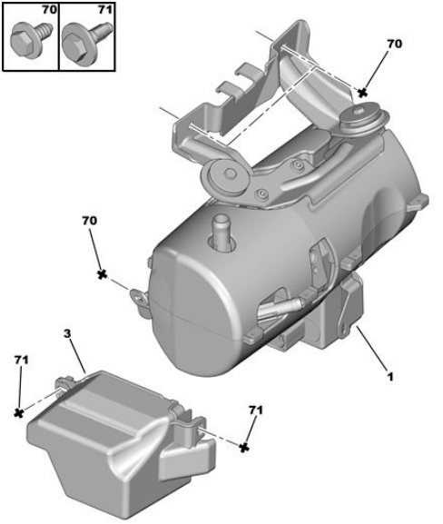

Ok, so this is your actual power steering pump (the part marked as '1'). It is an electro pump on your model:
So what I would do next is to check the level of fluid in the power steering reservoir. (make sure it is clearly marked as the power steering one, not the brake fluid). The type of fluid is specific. It must be LDS fluid - nothing else on this type of pump.
Make sure it is between the min and max. levels.

Where's that hidden on the C8 Marc ?
Man is, by nature, a lazy beast, he does not need twice encouraging to do nothing.
- GiveMeABreak
- Posts: 37396
- Location: West Wales
C5 MK I 2.0 HDi SX Wicked Red
C15 Romahome White
XM 2.0 SX Polar White
CX 20 Polar White
GS 1220 Geranium Red
GS 1000 Cedreat Yellow - x 5741
Re: C8 power Steering just stopped working.
It's inside the front left bumper area:
To get to it you need to:
Remove:
Remove:
Remove:
- The air filter box
- The securing bolt (1)
Remove:
- The front left-hand wheel
- The front left-hand splash-shield
- The air duct

GiveMeABreak wrote: ↑20 Apr 2019, 13:26 No, that's your ABS Block!
