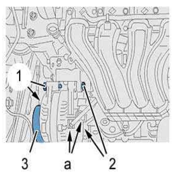

Here's the belt shown at (3) so you can at least check it is turning:

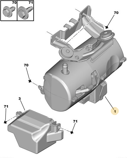

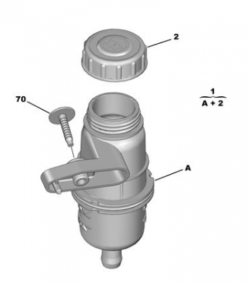

Also check your power steering fluid reservoir to make sure it is at the correct level:
The connector is underneath as shown on this diagram at (1)

I've looked at your images and can confirm there is plenty of fluid in the reservoir. But I can't locate the pump (your second image). Is it a little to the left of the reservoir (looking in from the front of the vehicle)?
