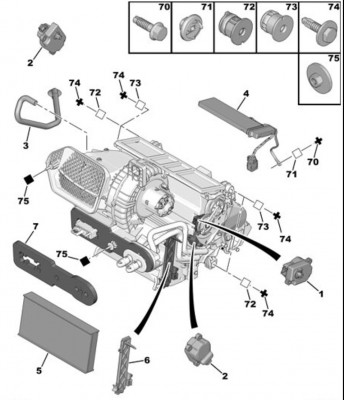

On mark 2 C5s with dual climate control, the reduction motors are items 1 & 2 on the diagram.
One set operate the air distribution flaps and the others the air hot and cold mixing, so you need to do some tests to ascertain which ones are playing up. Try diverting all air to the driver and then passenger side, and see if the air flow distributes on all of the positions on each side as commanded. Then try and alter hot one side and cold the other and then vice verse to see which is not responding.

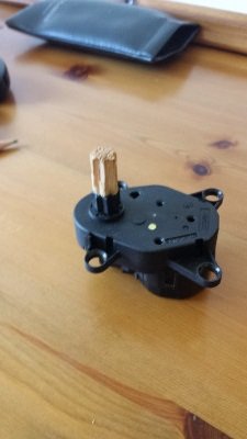

Here is the cheapest cure for worn socket in bottom flap ......
Bit of wood and some patience... extended motor drive is very expensive...
