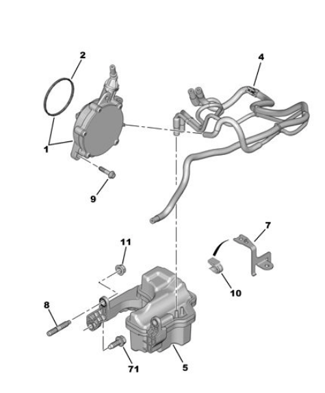

Hí, me again.
Can someone tell me what this "thing" is for?
- x 6945
Re: C5 2010 1,6 THP aut. deceleration noise
Brake Vacuum Pump possibly????

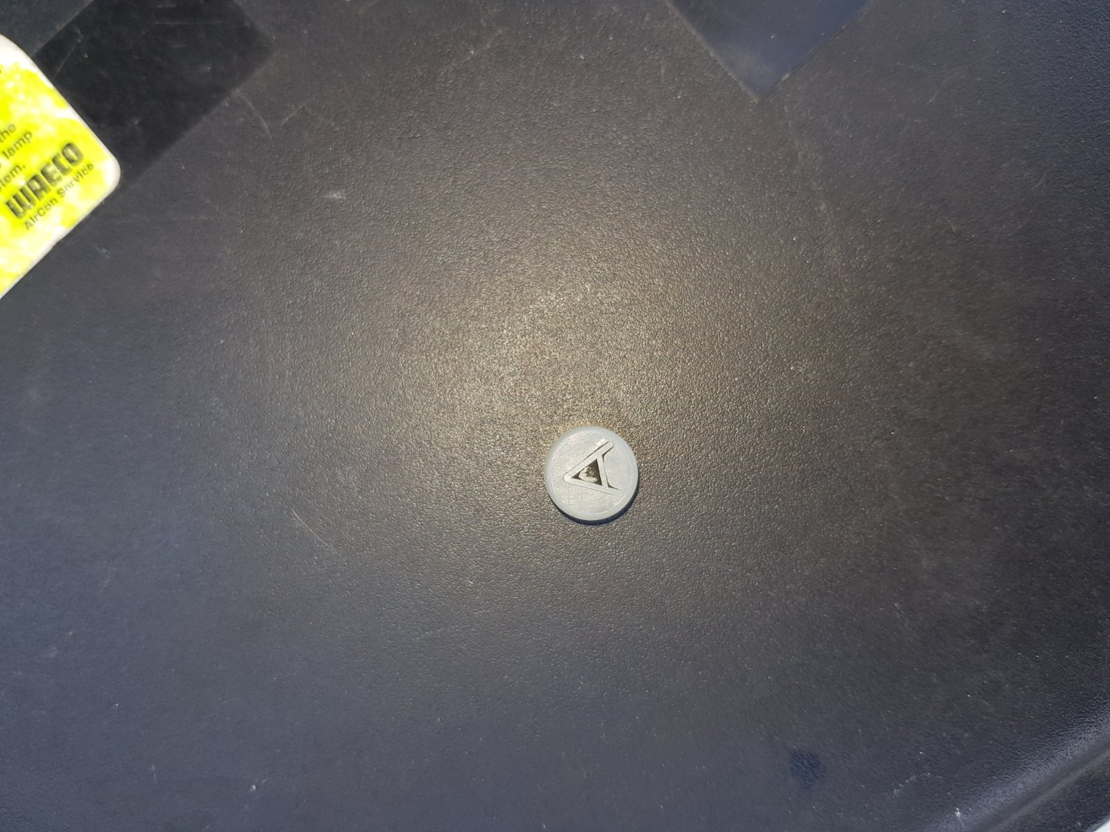

It looks to me like a gearbox breather (vent).
Can you please tell me what its function is?
- Posts: 10976
- Joined: 09 Nov 2005, 22:03
- x 1459
It allows a small flow of air into and out of the transmission case so that the case is not pressurised when it gets hot. The vent hole is small (and may be convoluted) so that minimal oil vapour is lost with the air. The flow through the vent is normally very small.
On some transmissions, the plastic vent cap is removed and the hole used for refilling the transmission fluid.
Wow, thank you
- x 6945
Well spotted Mike.

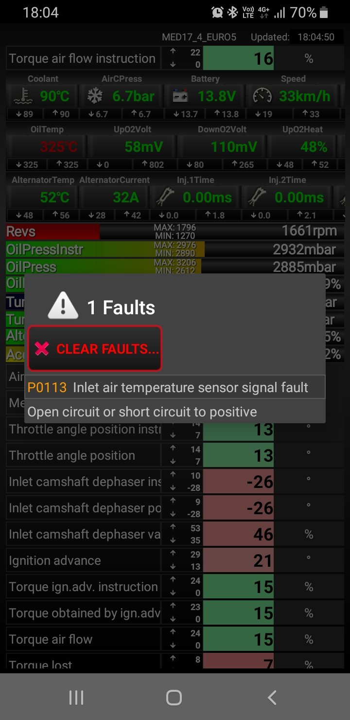

Dear all
Please help me again, what does the following (attached picture) stand for? What should I do, and where can I find it? It is a 2010 C5 THP 155HP.
Thank you in advance
- Posts: 10976
- x 1459
The air temperature sensor is (I believe) mounted on the hard plastic pipe that runs across the top of the engine from the intercooler to the throttle body.
Maybe the connector is loose?

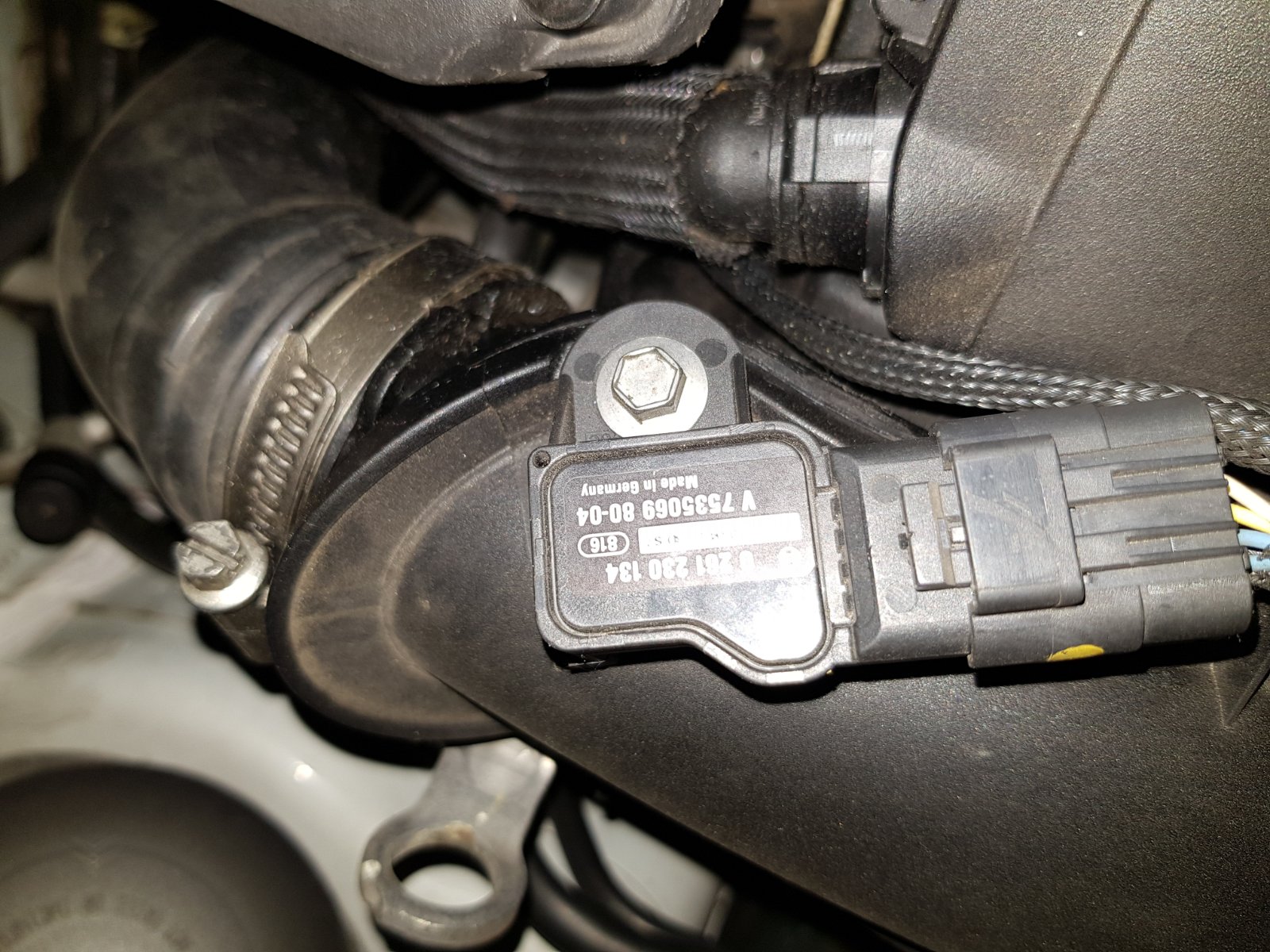

mf.lorant
- Posts: 47
- Joined: 16 Apr 2015, 18:16
- x 1
Then it should be this one I hope
