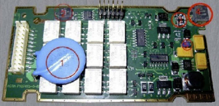

1) I suspect you may not have a full chip VCI - there are plenty of cheaper versions that do not have all the hardware to talk to some full CAN vehicles.

4b) Opening the unit - be very careful as it will void any warranty - but I suspect it is out of date now anyway. Yes you can determine the type of unit:
As you can see the cheaper versions are missing components circled which include Optocouplers........ When compared to a full chip example here
...and again on the other board - missing components......as compared to a full chip kit.
Further on some lesser units, there is a resistor missing arrowed that relates to CAN communication....
Ok, the VIN should be detected - but the DAM number will have to be entered manually - that is normal for both Lexia and PP2000. If it's not picking up the VIN then it's not right. Check that PP2000 is not already launched and hidden on the taskbat - sometimes the interface can obscure PP2000 and you are unaware it has launched but is hidden under the other window - so launching it again causes a problem.

The unit is in fact a clone. Pfft.
