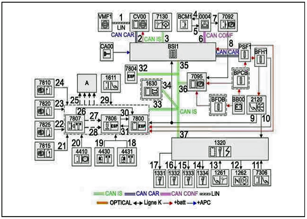

PSA servers are down for maintenance, so I can't double check your spec., but if you have the electronic parking brake which I think you do from memory - again this is controlled directly by the ABS / ESP ECU.
This is the Dynamic Stability Control (Electronic Parking Brake) Flow Chart. It should give you some idea of the interplay between the systems.
Vehicle’s lateral acceleration, Vehicle roll speed, & Longitudinal acceleration are received / Transmitted by 7804 (Gyrometer, Accelerometer & Yaw Speed Sensor) and the BSI. The signal type is CAN Is.
Vehicle’s lateral acceleration, Vehicle roll speed, & Longitudinal acceleration are received / Transmitted by 7804 (Gyrometer, Accelerometer & Yaw Speed Sensor) and the 7800 (ESP ECU). The signal type is CAN Is.
So the CAN Is is interconnected so a lot of the related components as seen by green on the diagram.
Click Image to Zoom
Note: dotted lines represent Hydraulic Connections
Click Image to Zoom

- Posts: 99
- Joined: 24 Dec 2012, 14:35
- Location: Cumbria
- My Cars: Citroen c5 , Audi A3 S line TDI
Re: good info on Yaw Sensor
absolutely brilliant information Marc !!
massive thanks
Andy
massive thanks
Andy
