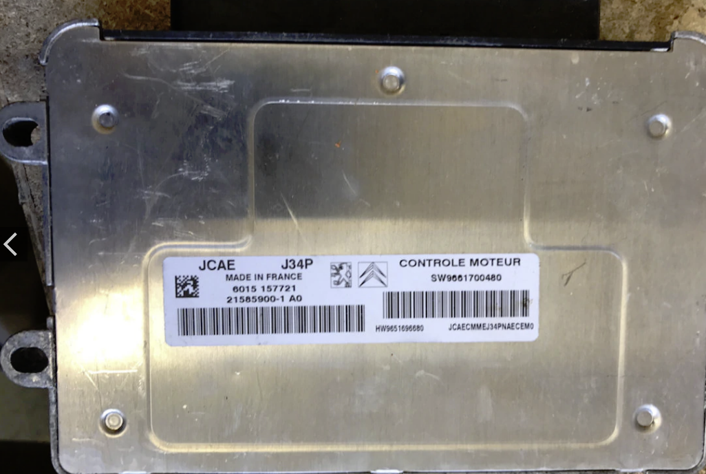

Any label with part numbers - codes?
Dibber
Posts: 56
Joined: 19 Mar 2019, 10:26
x 4
Re: Needing A C2 Wiring Diagram
Unread post by Dibber »
Yes. Can't seem to post another image though..

Dibber
Posts: 56
x 4
x 6956

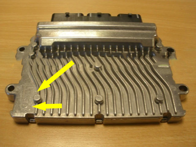

Aahh, so I have found this identical unit which explains the mystery a little further... in 2005, Valeo acquired the engine electronics division of Johnson Controls, so that would make sense with your car build date being Nov 2005.
Identical label markings to yours, but if you look at the second picture on the left hand bottom corner, you'll see it is a Valeo unit where I've arrowed in yellow (note: I've removed the advertising of the seller, so the fins look a little out of alignment - that's me :-D

Good detective work there Marc! I had read Johnson was taken over by Sagem then by Valeo but who knows. I think your version sounds more plausible given the evidence in the photos. Now that is established I wonder if a wiring diagram can be procured. :dunno:
