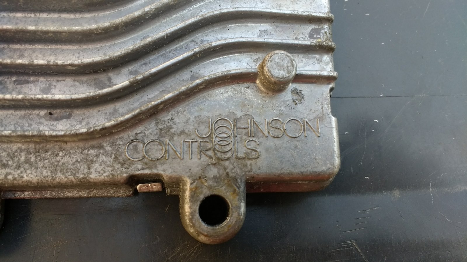

My coil pack was a Johnson Controls brand as well. I believe the ECU is original but will maybe pull out the ECU and see if I can get a manufacturing date code. I was wanting to check resistance readings on injector and coil pack wires. Using the first diagram pin outs none of the injector wires showed any continuity to the corresponding pins on the ECU. Two of the coil pack wires appeared to be correct but the remaining two did not tally up.

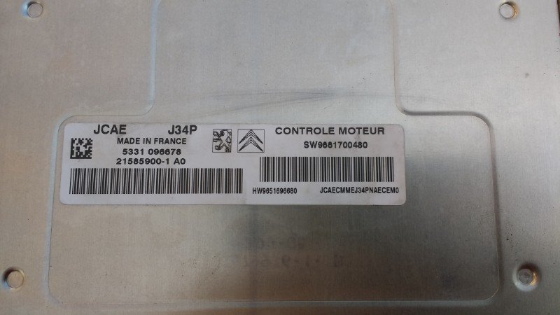

Let us know the part number or codes (photo even) and I’ll see what it reveals.

Any label with part numbers - codes?

Yes. Can't seem to post another image though..

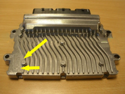

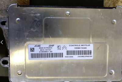

Aahh, so I have found this identical unit which explains the mystery a little further... in 2005, Valeo acquired the engine electronics division of Johnson Controls, so that would make sense with your car build date being Nov 2005.
Identical label markings to yours, but if you look at the second picture on the left hand bottom corner, you'll see it is a Valeo unit where I've arrowed in yellow (note: I've removed the advertising of the seller, so the fins look a little out of alignment - that's me

Good detective work there Marc! I had read Johnson was taken over by Sagem then by Valeo but who knows. I think your version sounds more plausible given the evidence in the photos. Now that is established I wonder if a wiring diagram can be procured.
