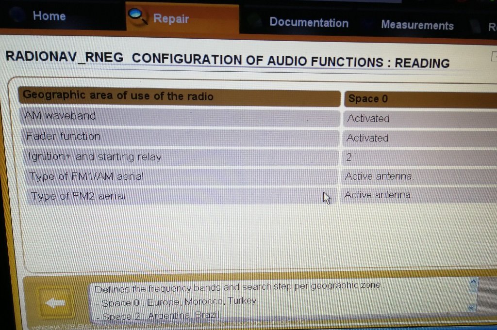

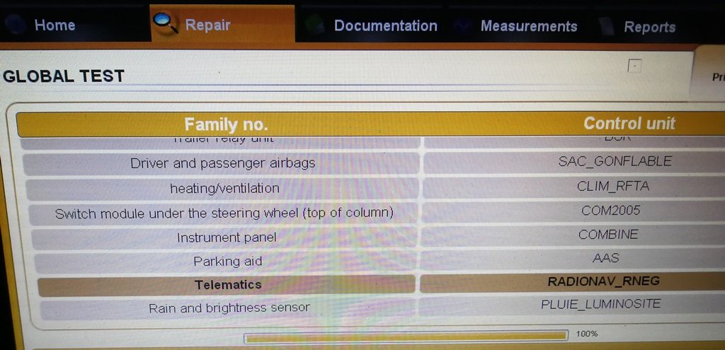

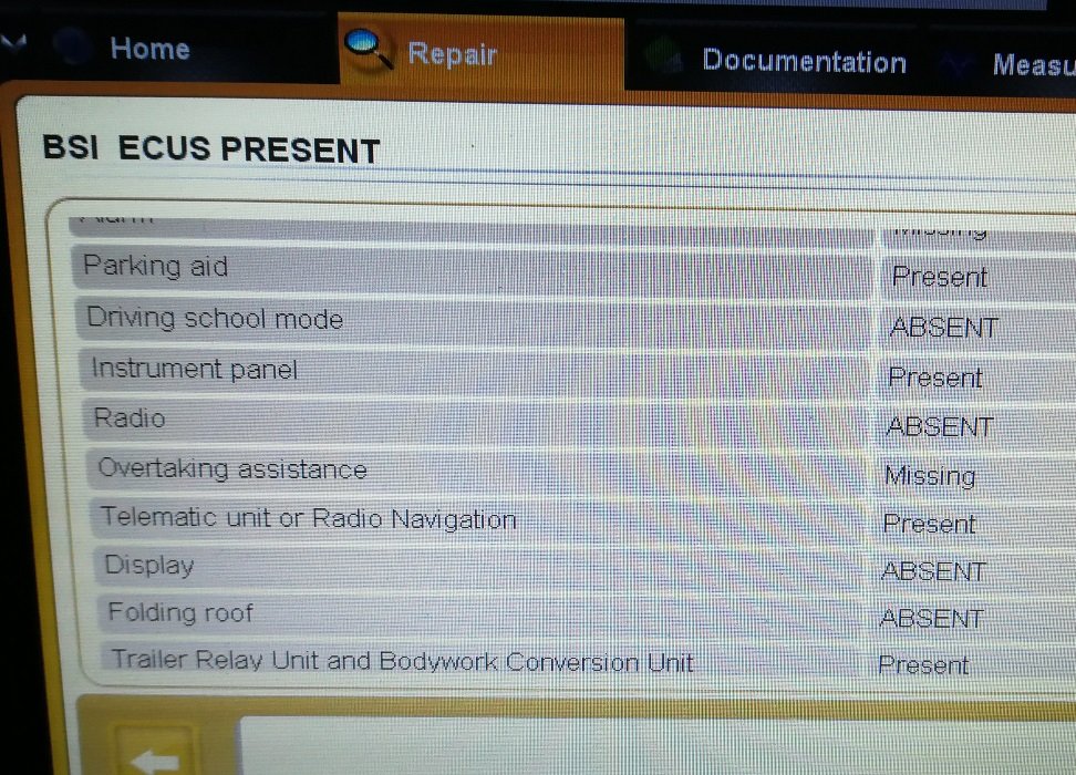

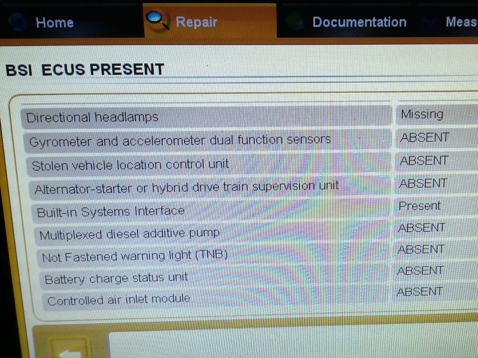

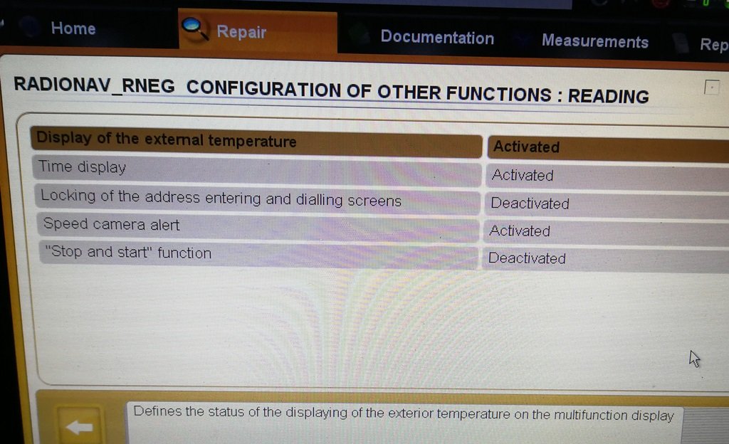

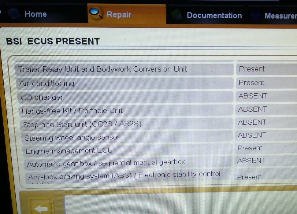

Are these the missing options?
I have 'SPACE 0", I can set SPACE 0, SPACE 2, SPACE 3 and SPACE4, but only SPACE 0 is for Europa. I haven't been changed this.

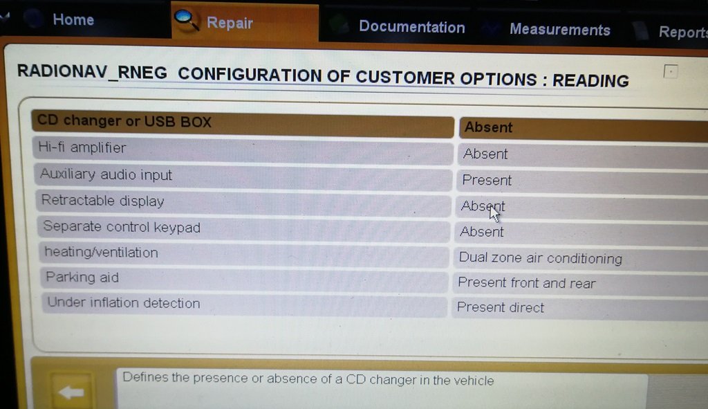

I can set 'Missing', 'Single zone air conditiong' and 'Dual zone air conditioning'. I set this parameter to 'Missing'. The error F020 (No communication with air conditioning ECU) has disappeared in RADIONAV_RNEG fault reading.

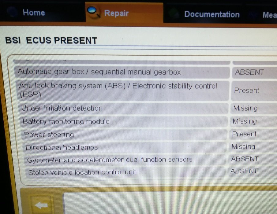

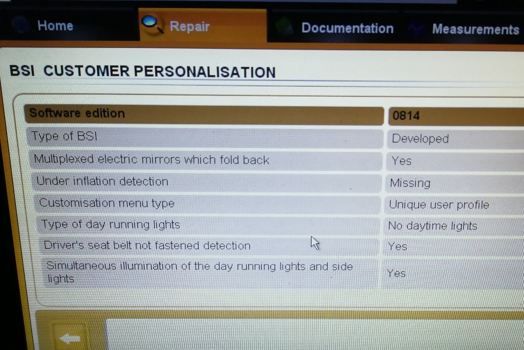

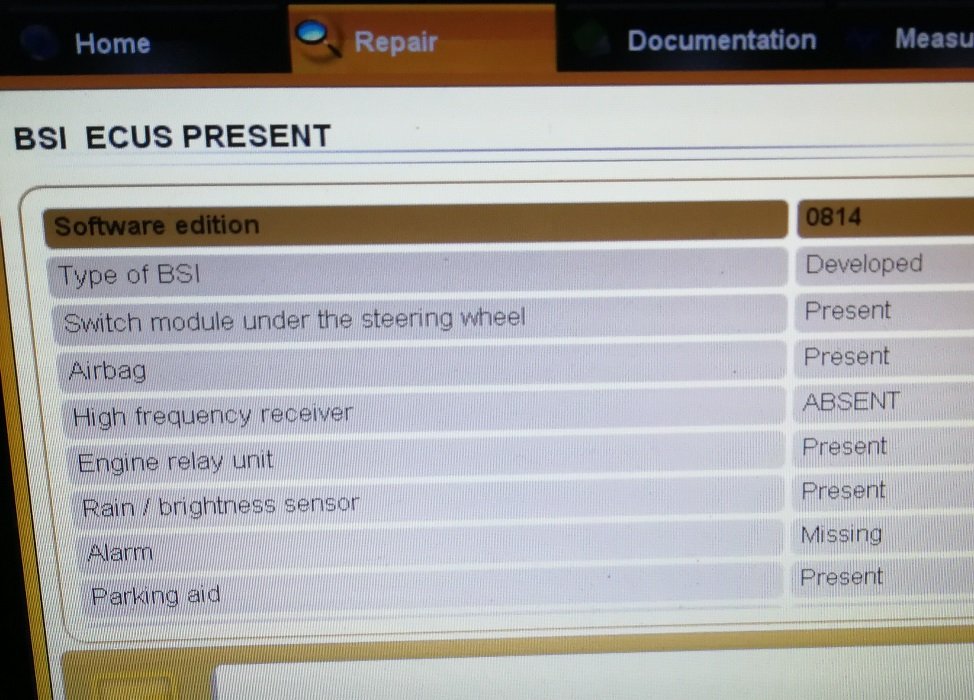

Below I attach a few more images with options. Are they set correctly?
Thank you in advance
GiveMeABreak wrote: 29 Mar 2019, 10:13 There are some options I cannot see - these are usually found when you go onto the RNEG ECU from the Global Test and then into the manual configuration. You have some of the options shown in the BSI, but I can't see the others.
GiveMeABreak wrote: 29 Mar 2019, 10:13 One observation on the data that I have -
"Geographic area of use of the radio" - you have 'SPACE 0' and my data says it should read (Europe). Has this been changed?
GiveMeABreak wrote: 29 Mar 2019, 10:13 The other thing my data says is that the "Heating/ Ventilation" setting should be 'Absent', where you have it set to 'Dual Zone Air Conditioning'. Sometimes this does not mean you do not have it - but that it is not supposed to be set here. You might want to try and change these 2 options back to the values the document I have says and see if that makes a difference.

Ok, so I've had a look this evening and I have an issue with accessing the specific BSI document for your vehicle, so I cannot compare the options against your picture.
I have looked at the ones you highlighted and they appear to be right.
It took longer as I had to copy your pictures into a single document to make it easier to see - as it kept going to your image hosting service! For future reference you know that you can upload images directly on this forum - just go to the full editor and attach the images from your PC.
