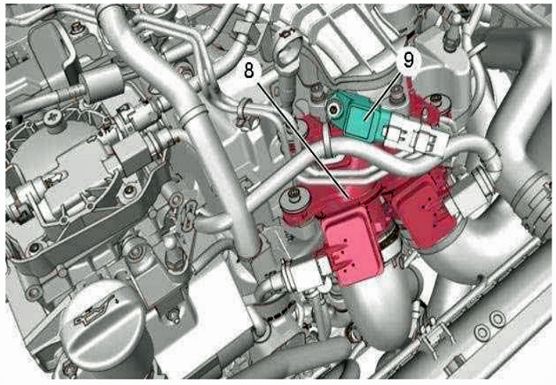

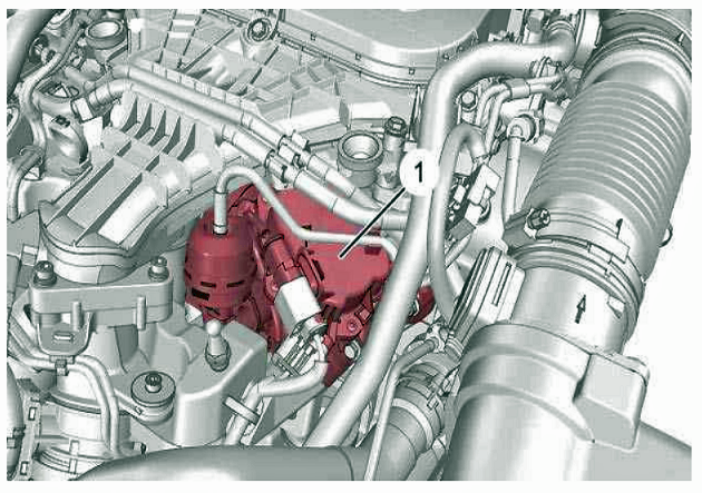

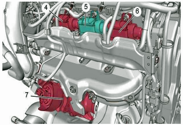

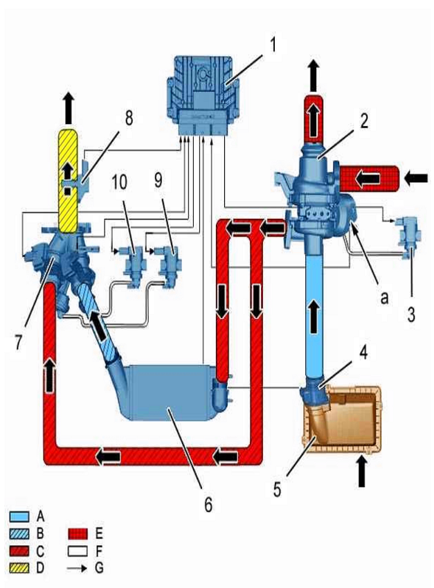

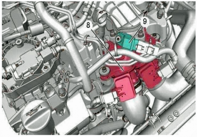

He has the Double Air Doser Mike - this is the DW10CTED4 engine with Delphi Injection:
So here are the Air Supply Components:
EGR Components:

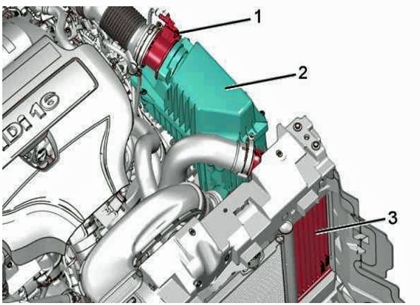

| (1) Air flow meter (Air flow by mass). (2) The air inlet housing. (3) Turbocharger air cooler. | |
| (4) Proportional electrovalve controlling the variable resistance turbocharger. (5) Cold air circuit electrovalve. (6) Hot air circuit electrovalve. (7) Variable geometry turbocharger | |
| (8) Double inlet air doser unit . (9) Inlet air pressure and temperature sensor. |

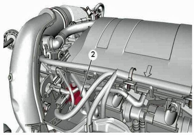

| (1) Exhaust gas recycling module : Electrically-controlled exhaust gas recycling valve Exhaust gas recirculation heat exchanger Pneumatic exhaust gas recycling heat exchanger bypass flap | |
| (2) Control electrovalve for the EGR heat exchanger by-pass. |

Item 8 (air doser) and item 6 (electrovalve) are main suspects as they are prone to contamination (sticking).
I would test these first (further tests may be necessary).
Item 8 houses two butterfly valves. Clean and check they both open and close smoothly.
If not, replace air doser.
Example
Item 6 is has a very small internal air filter. If internal air filter can be cleaned, clean it.
If not, you may need to replace electrovalve.
Example

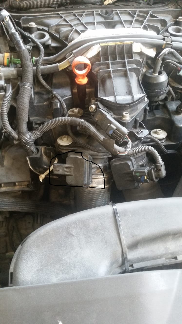

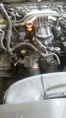

I am a mechanic now.
the socket I have marked is idle.could this be related to

Please note that on the DW10C engine, the by-pass function is not active, the hot air (by-pass) flap is only activated in the event that the cold air (mixer) flap seizes.
So although you have the double air doser, the left hand plug is purposefully disconnected (the wiring plug will be hidden) and there should be no vacuum pipe attached either. So DO NOT connect this up, as it is designed to be left off!
