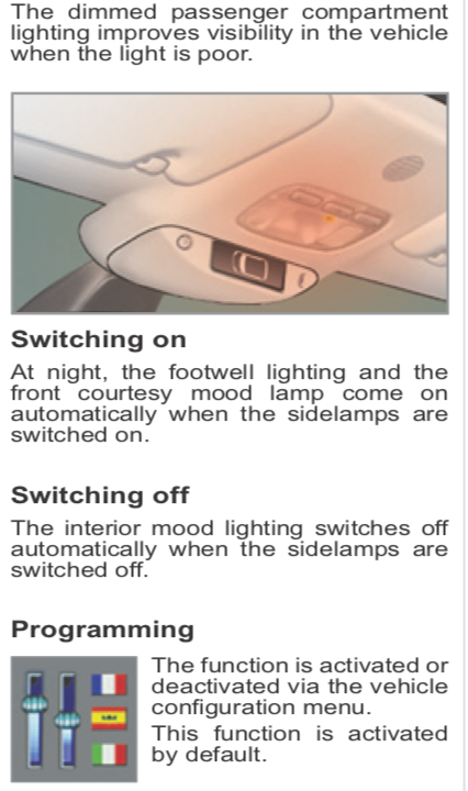

The only light that comes on when I put side lights on is a little orange dot between the map reading lights, the book says "The dimmed passenger compartment lighting improves visibility in the vehicle when the light is poor. At night, the footwell lighting and the front courtesy mood lamp come on automatically when the sidelamps are switched on" and it shows a picture of the courtesy lamp glowing (as well as the little orange dot being on).

I c.ant copy the electronic version of the picture but it definitely shows the courtesy light glowing around the amber LED, plus it also mentions the footwells and there are no lights that come on there, only the one when you open the door. Would I be able to get a copy of the full spec sheet please?

pgcarter22 wrote: 25 Feb 2019, 17:57 The only light that comes on when I put side lights on is a little orange dot between the map reading lights, the book says "The dimmed passenger compartment lighting improves visibility in the vehicle when the light is poor. At night, the footwell lighting and the front courtesy mood lamp come on automatically when the sidelamps are switched on" and it shows a picture of the courtesy lamp glowing (as well as the little orange dot being on).
I checked our 308 CC and it is the same. The 3mm point LED glows dimly when the "Ambient Lighting" is enabled, but it is so feeble that I had never noticed it. There is no sign of the footwell lights coming on with ambient lighting. I wonder if there is a BSI setting that controls the footwell lights in this regard? or maybe the handbook is just wrong.

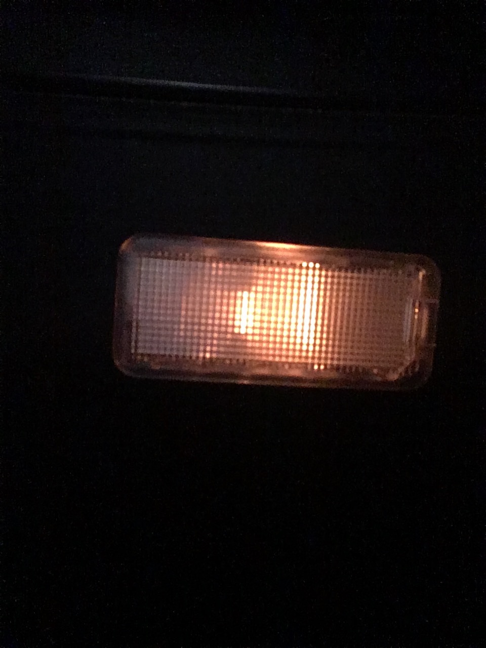

Managed it! =D>

Ha ha, well what do you know, ambient lights are working! 3rd one is footwell light with door open, 2nd one is with door closed (ambient/mood lighting) and the 1st is courtesy light cluster (amber dot and button symbols ambiently lit!), no wonder I've never seen them, they were obviously overpowered by the stars shining through the window. Oh, and for the record, they are on all the time, even when you turn the lights off (unless they have a time delay) :lol:

Technically I haven't actually seen it, I just know it's there by the power of the selfie feature on my phone. To get down low enough to see it I would have to open the door and trigger the full footwell light. You can't actually notice they are on when they are, only with a selfie camera or mirror. No wonder Peugeot are so coy about them, probably embarrassed :rofl2:
