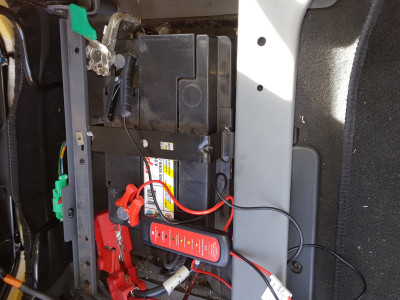

HI Mark,
Its been a while since I originally posted, but today was really nice so I thought I'd have a look at my battery termimals as giving my Xpic its first proper clean inside and out since the winter.
A couple of weeks ago I purchased a cheap battery tester from my local Aldi. The Battery may be past its best as the results in the photos show, so in the next couple of weeks, im looking at replacing. Which is the correct one for my car? Its a 2007 1.6hdi desire vaiant. Im looking to buy from eurocarparts as they seem very reasonable,
Thoughts
