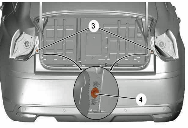

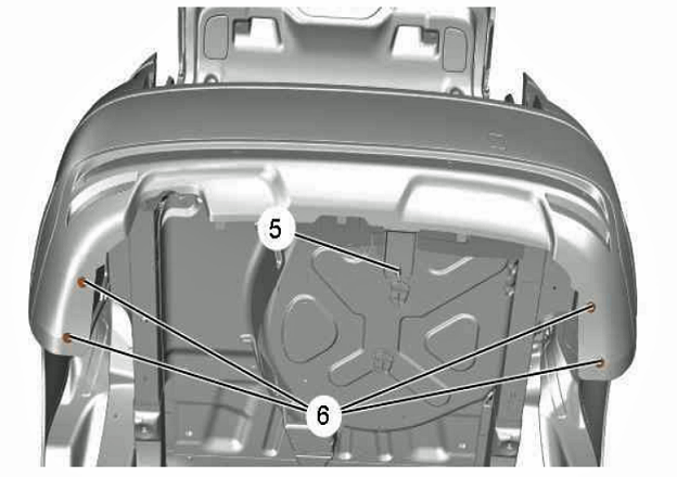

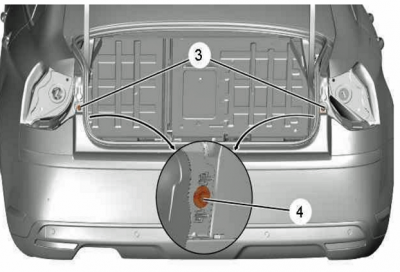

C5 X7 Saloon Rear Bumper Removal
Pre-requisites:
If raising vehicle off the ground at the rear where the wheels will not be supported, raise suspension to HIGH and remove the LDS cap. Do not get under a hydraulic Citroen that is not independently supported.
Disconnect Battery (following Procedure)
Refitting
Proceed in the reverse order to removal.
Tighten the bolts (4) to 1,1 ± 0,2 daN.m.
Tightening of the wheels:
Aluminium wheel rim : 9 ± 1 daNm
Steel rim 11 ± 1 daNm
Follow Battery Reconnection Procedure to reconnect the battery.
Check all the equipment works.
Pre-requisites:

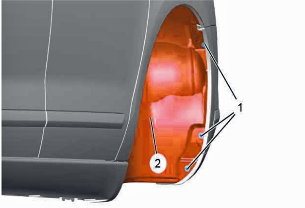

- Remove the rear wing lamp Units
- Follow Battery Disconnection Procedure
- Partially release the CD Changer where Factory Fitted
N.B.: Place the vehicle on a 2-post lift.
| Remove:
Remove:

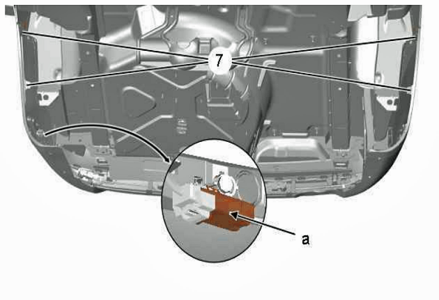

| Remove the bolts (7). Disconnect the connector ( as "a") (according to equipment). |

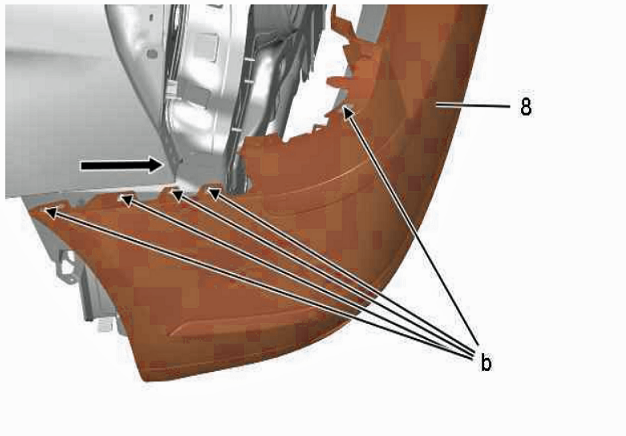

| Unclip the rear bumper (8) ( as "b") (on each side). Remove the rear bumper (8) (In the direction of the arrow ). |

That bit sounds so simple but it took me several days to work up enough courage to be quite vicious pulling the bumper off. Be warned - it is not easy.GiveMeABreak wrote: 20 Mar 2019, 11:33Unclip the rear bumper (8) ( as "b") (on each side).

At least (on the face of it) they haven't failed to mention bolts near the wheel arch as was the case with the tourer instructions which I obtained from another source. This resulted in slight bending of the metal at that section as I tried to remove said bumper with too much exuberance.

Do you pull the bumper parallel to the ground, like sliding backwards or do you also have to tilt/pull outwards? Would be good to see how it clips so at least I have an idea which way to apply force!

Sorry to dig up old thread, but trying to remove the rear bumper, got all screw/bolts off, but can't shift the bumper at the sides.Paul-R wrote: 20 Mar 2019, 13:41That bit sounds so simple but it took me several days to work up enough courage to be quite vicious pulling the bumper off. Be warned - it is not easy.GiveMeABreak wrote: 20 Mar 2019, 11:33Unclip the rear bumper (8) ( as "b") (on each side).
How did you unclip the clips?
I'm afraid of breaking it.
