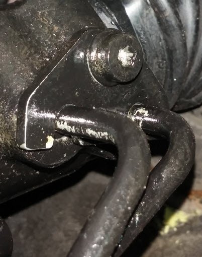

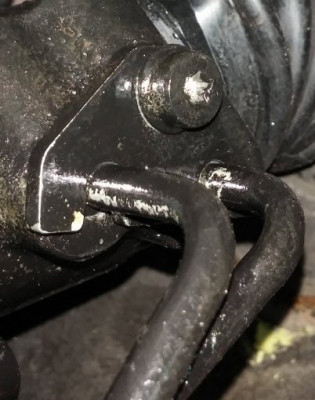

Good Morning All,
One guess everyone to what I am refering to ?
The low pressure pipe to the steering pinion.
It is only weeping gently but I'm considering my options.
I'm thinking of using epoxy resin and sealing it permantly.
My only concern is, will the LDS fluid react with the resin.
Thoughts please,
Kenny

I take it it's this one again, Kenny.
viewtopic.php?f=3&t=61239&p=591754#p590623
Did you try a slightly thicker Viton O-ring? How was it left, eventually?

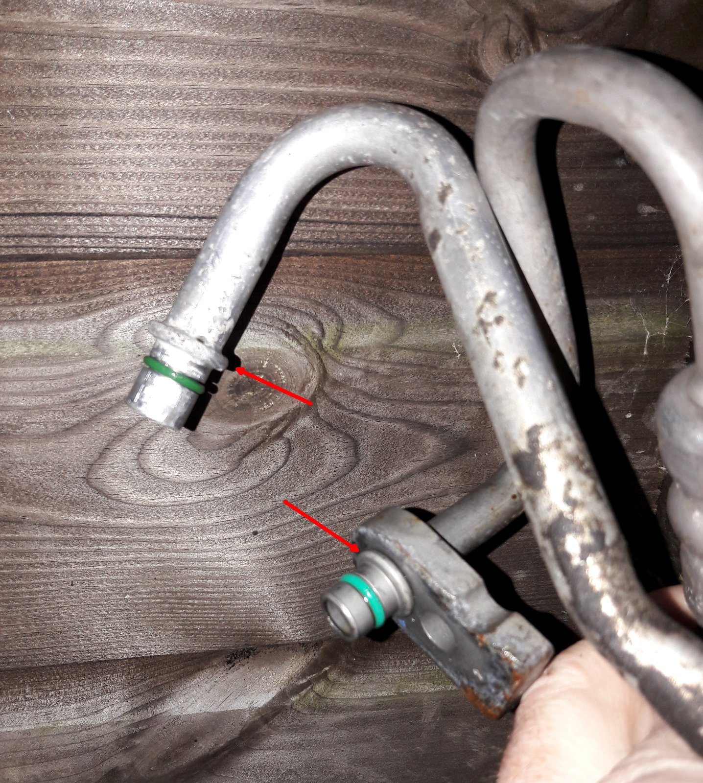

In common with quite a few modern car steering pipes, these should only really be regarded as single use. If you're lucky, you may get them to seal a second time, but the pressed collar on the HP and LP pipes is designed to seat tight into the pipes sockets on the rack and once it's disturbed it's pot-luck if it'll go back exactly in the right position. If you could find a way of reforming the collars or getting a wafer thin seal to sit on the collars so it seats against the pipe sockets on pinion casting then you might be on to a winner.
Note - one of the above pipes is for the pump end, but the principle is the same.
