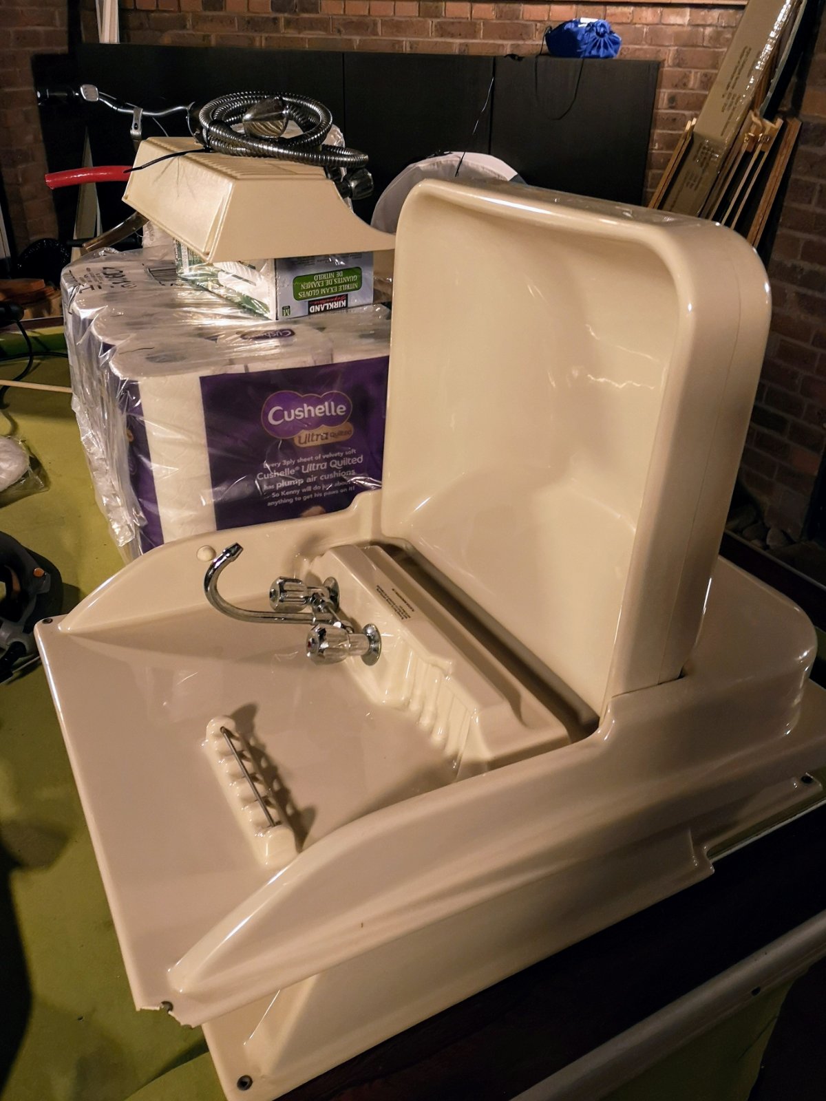

After a five hour round trip (yay traffic...) I have now this chunk of delightfully eighties beige plastic in my possession.
One bit of damage to one corner but nothing we can't fix with a little bit of fibreglass or filler.
Really glad that despite having been rummaging on and off for months and not turning up anything aside one fuzzy picture of it, I've managed to turn up a match for what would originally have been fitted.
Hopefully get it fitted tomorrow.
