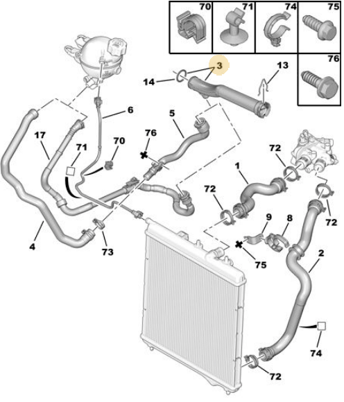

Re: DS3 waterpump tube fitting?
Ok, we got there in the end!
The clips are 13 & 14 in the diagram and the pipe is part 3.
Thanks Marc, yes, the part is number 3 in that pic, but in this photo 13 is a clip and 14 is an O-ring. I am not looking for them.
If you look the eBay photo, you see that there are three holes in that pipe. I’m looking for what goes into those holes.

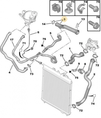

I would not be surprised if the holes are not used. This random picture of a THP engine indicates that the holes are floating in free space:
The pip is in no danger of escaping, as it is firmly wedged between the pump and the thermostat housing.
Here is another picture from the net, showing the thermostat housing and the clip:
Viitonen
- Posts: 62
- Joined: 21 Jul 2018, 21:46
- x 11
Oh, great! Thank you guys, now I don’t need to worry about those holes since they are not in use
