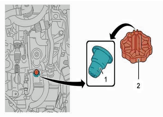

Refit the metal part ( 1) of the air vent Using a Ø 18 mm drift and a hammer.
Clip the plastic part ( 2) onto the air vent.
N.B.: The gearbox air vent is available from Citroen Parts.

- The air vent assembly ( 1) and (2) of the gearbox Using tool [1]

I appreciate it. Ok. The oil level hole. I am trying to figure out where it is situated. Seems like at the back of the gearbox close to the exhaust downpipe?
- x 6960
Re: Mk1 c5 5hp20 oil level
I've never had one of these Corne, so couldn't tell you for sure, but it looks like that's the location from the picture.

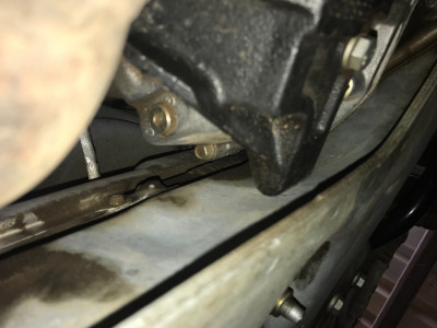

Success.
Gearbox oil changed in correct sequence. And I saw the level plug. Tried to take the picture exactly as in the diagram. Uses a 6mm allen key to loosen the level plug.
Ended up putting in around 3 liter which is what I presume is what needs to come out. Oil wasn’t that dirty. Next gearbox oil change in a month.

Hope picture helps
I used ravenol 5/4HP fluid which according to their website is the correct replacement oil. Citroen is wayout with their price. So this is next best. A friend uses it and all is good after few thousand miles. So. Let’s see...
Thanks for the Help Marc.
Hope picture helps

Thanks for the pictures, that's great Corne. Pleased that's another job done well!
