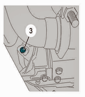

I appreciate it. Ok. The oil level hole. I am trying to figure out where it is situated. Seems like at the back of the gearbox close to the exhaust downpipe?

I've never had one of these Corne, so couldn't tell you for sure, but it looks like that's the location from the picture.

Haha. Well. If I find it I will be sure to put a picture here for future reference

Sounds like a plan and will compliment the procedure - I'll add it into my post for completeness.

Success.
Gearbox oil changed in correct sequence. And I saw the level plug. Tried to take the picture exactly as in the diagram. Uses a 6mm allen key to loosen the level plug.
Ended up putting in around 3 liter which is what I presume is what needs to come out. Oil wasn’t that dirty. Next gearbox oil change in a month.
I used ravenol 5/4HP fluid which according to their website is the correct replacement oil. Citroen is wayout with their price. So this is next best. A friend uses it and all is good after few thousand miles. So. Let’s see...
Thanks for the Help Marc.
Hope picture helps

Thanks for the pictures, that's great Corne. Pleased that's another job done well!
