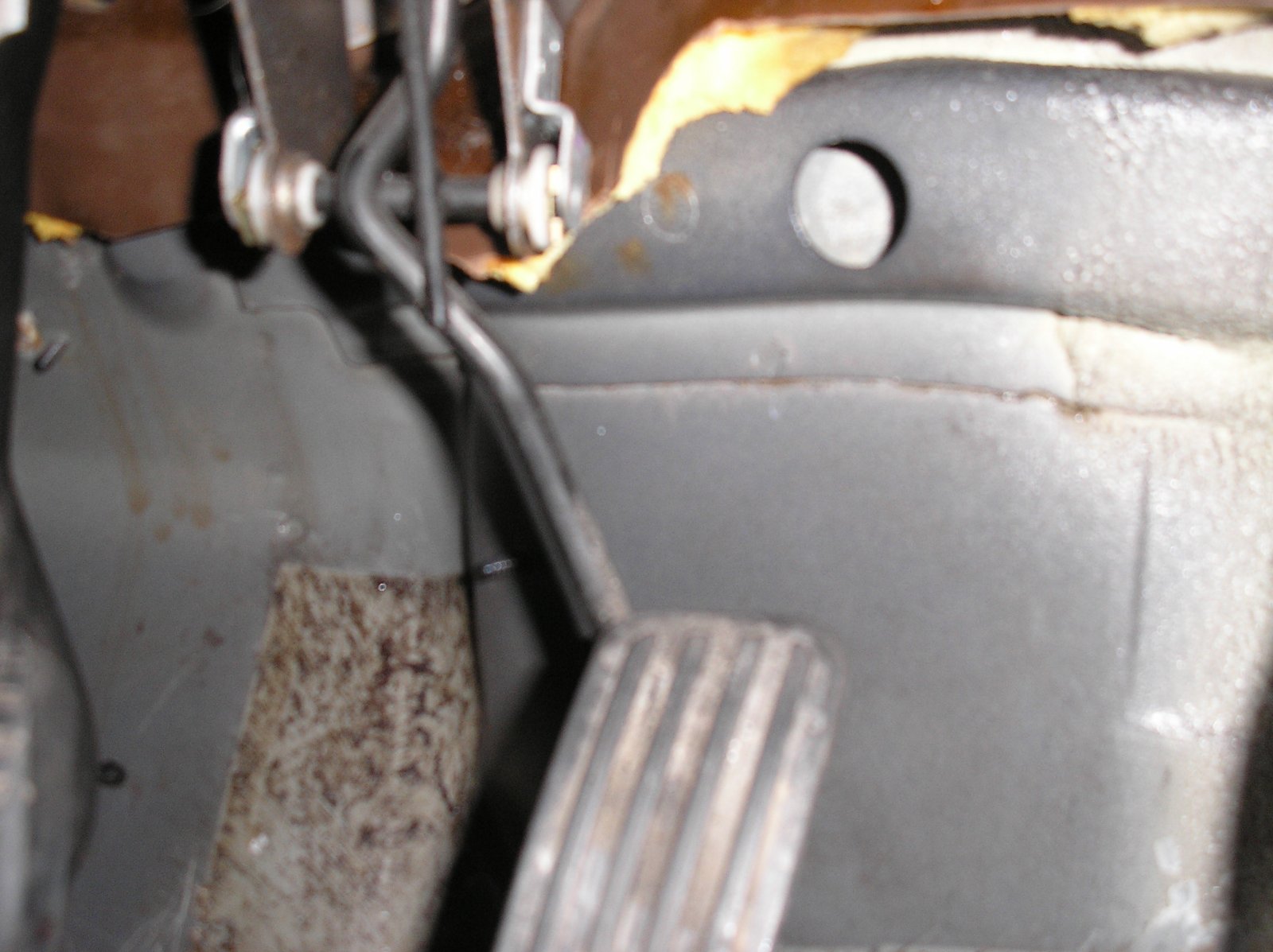

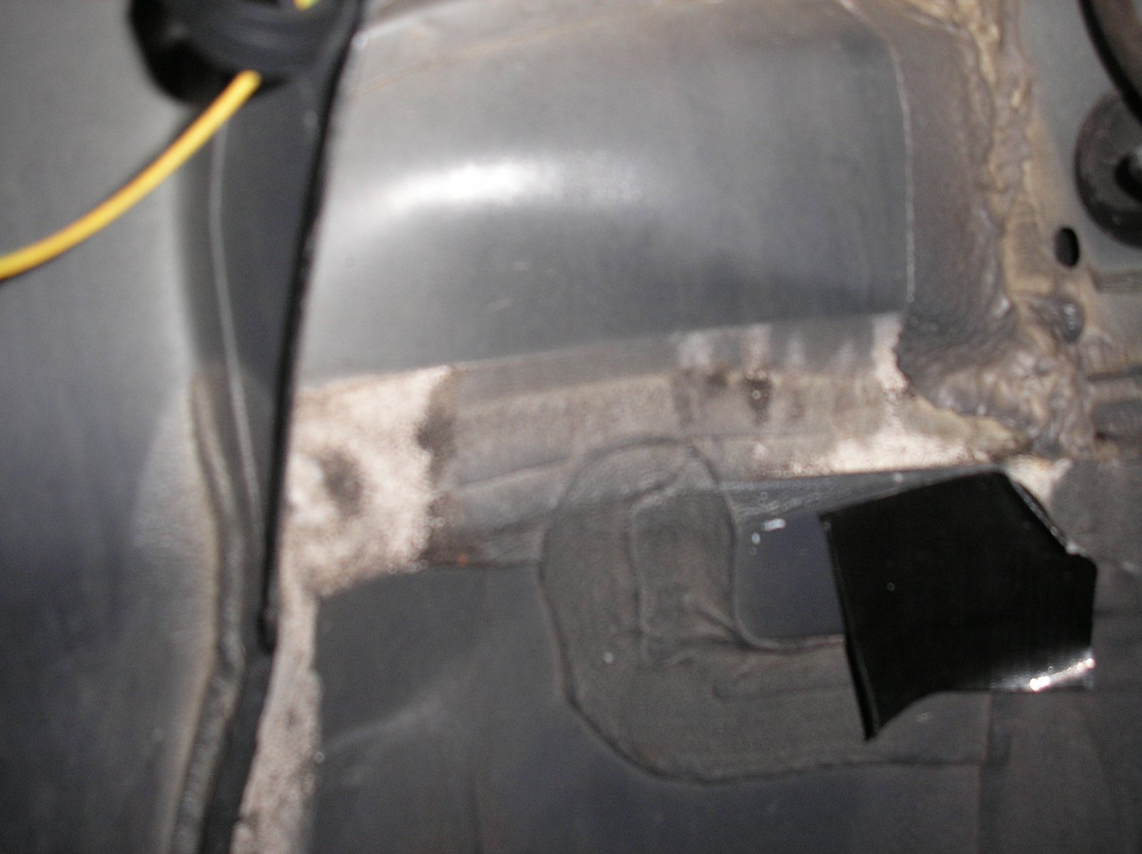

top picture is inner wing and bulkhead, the tape is covering the plastic liner clip hole, and the shelf is just above it. You can just make out dribble lines for water coming thru the spot welded seam of the skuttle floor to bulkhead seam.
picture 2 is drivers floor and air con drain pipe, with seam from left to right and box section rearward. This had sound deadening bitumus which was holding water so was removed. Water dribble down from the above box section by the throttle pedal and gets inside/between the seams. If not corrected the seams are gunna rot in on time.
engine picture shouldnt be there but do you know what it is??
next picture is the rear passenger foot well area, again with seams that end up wet as weater makes its way rearward as the car is pointing up hill.
last picture is the box section by the throttle pedal thats fills with water, but from where?? it dribbles out and wets the drivers floor and gets into the seams etc. On ly a light wire brushing removed the bubbling paint and bad seam sealer, with corrosion underneath.

OK, the skuttle area seams where flooded with hammerite and allowed to go off. The skuttle drain areas in the skuttle where re painted and allowed to go off. The under wind skuttle drains area and the plastic inner wing liner plastic fastener "shelf " area was painted and aloowed to go off. Any area and seam in the under wing area was also painted and allowed to go off. The small area of rust on the wing in the "mudflap" area, the area a mudflap would be fitted if it had them, was de rusted and painted at the same time.
The car was rained on for a few days and remained totally dry inside, with no water coming out from the pedal area "box" and flowing down into the various box sections on the car floor.
No water came in at all, SUCCESS!!!!!!!! thank you god.
