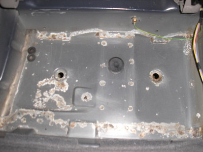

OK, 53 plate xsara picasso 1.8 dohc petrol, black.
When we got the car in september 2018 we checked for blocked skuttle drains as a matter of course, and washed with a hose pipe the lower "mudguard" area on the front as they where dirty.
Lots of mud and dirt etc. came out.
Noticed a small slit opening where the inner wing plastic liner to wing did not seem to fit very well, a design feature perhaps??
Other picasso's seem to have these as well.
Car suffered from some condensation problems so possible water leak into the car.
Recently lifted both rear cuddy box lids and "boxes".
Found a lot of water in rear drivers side and some in the passenger side.
No sun roof and no roof aerial.
Door seals and door cards good with no visual leaks.
The drivers side rear passenger seat is removable. The gap between the seat area and door card carpet was damp, the foam quite damp. Carpet lifted and the outer steel/rubber part which was supposed to be riveted to the car was not, so letting in water in that area?? Its now riveted in place. It had never been riveted since leaving the factory, a friday car??
So rear seats out ( a good idea citroen!! ) as well as rear carpet. Passenger false floor removed, and all the bits needed to remove the front carpet/false floor, boy what a PITA.
All the felt underlay covering was totally saturated on the drivers side and was binned. Water level on this side was about 2 inches as car was on an incline facing up hill, and the front of the car was raised and wheels off. Water flowed to the rear and collected.
The passenger side was not so bad and dried out.
The brown plastic covered sound deadening sponge ( boy is that good at sucking in water and retaining it!!! ) was peeled back and squeezed out as best as possible, but was soaking wet.
The centre section was removed as painlessly as possible and dried. The front bulkhead section was cut just below the throttle pedal area and across on the drivers side, removed to dry out. The passenger side was peeled back and allowed to dry.
The inner wing plastic where removed both sides and cleaned of accumulated leaves, dirt etc.
The wind screen wiper arms where removed as well as the plastic skuttle cover and motor for good access to the skuttle proper.
The skuttle area was re cleaned.
It seems that, water collected in the skuttle area and directed to the skuttle drains, drain down onto a "shelf" under the plastic inner wing liner and pass very close to one of the liners plastic clip holes.
It seems that water can collect on this "shelf" and may enter the box section there. This box section seems to form part of the inside box section as well that fills with water and can overflow into the car via the large hole. The collected water also drains very very slowly via the low point into the car cabin.
Also the skuttle floor to bulkhead panel spot welded to the bulkhead dribbles water onto the shelf area.
see pictures.
Water gets under the paint and corrodes the metal. Water gets into the seams and corroded them as well. Water gets under the bitumouis panels and stays there, corroding the metal.
I have seen this before on a despatch.
All the drivers side bitumous panels have been removed. The bitumous panels an the passenger side will be removed also where the trap water and get into the seams.
I am waiting for a dry spell so i seal the shelf area, skuttle floor seam and anywhere else under the wing area that may leak water into the inner box section and then into the car. Once done i will flood the cabin seams etc with hammerite to hopefully stop corrosion, or at least slow it down for a few years. I intend spraying the brilliant water absorbing foam with an "oily" mix and allow to dry before refitting. All box sections will be "oily sprayed" inside during the summer, if we keep this car that long that is.

ok computer being a bitch......no pics yet....seems the card reader has died but the camera method works thank god.
top picture is inner wing and bulkhead, the tape is covering the plastic liner clip hole, and the shelf is just above it. You can just make out dribble lines for water coming thru the spot welded seam of the skuttle floor to bulkhead seam.
picture 2 is drivers floor and air con drain pipe, with seam from left to right and box section rearward. This had sound deadening bitumus which was holding water so was removed. Water dribble down from the above box section by the throttle pedal and gets inside/between the seams. If not corrected the seams are gunna rot in on time.

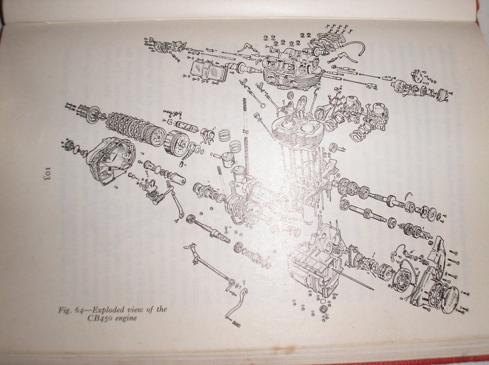

engine picture shouldnt be there but do you know what it is??
next picture is the rear passenger foot well area, again with seams that end up wet as weater makes its way rearward as the car is pointing up hill. last picture is the box section by the throttle pedal thats fills with water, but from where?? it dribbles out and wets the drivers floor and gets into the seams etc. On ly a light wire brushing removed the bubbling paint and bad seam sealer, with corrosion underneath.

OK, the skuttle area seams where flooded with hammerite and allowed to go off. The skuttle drain areas in the skuttle where re painted and allowed to go off. The under wind skuttle drains area and the plastic inner wing liner plastic fastener "shelf " area was painted and aloowed to go off. Any area and seam in the under wing area was also painted and allowed to go off. The small area of rust on the wing in the "mudflap" area, the area a mudflap would be fitted if it had them, was de rusted and painted at the same time.
The car was rained on for a few days and remained totally dry inside, with no water coming out from the pedal area "box" and flowing down into the various box sections on the car floor.
No water came in at all, SUCCESS!!!!!!!! thank you god.
The affected floor was wire brushed and painted to slow down the corrosion process.
