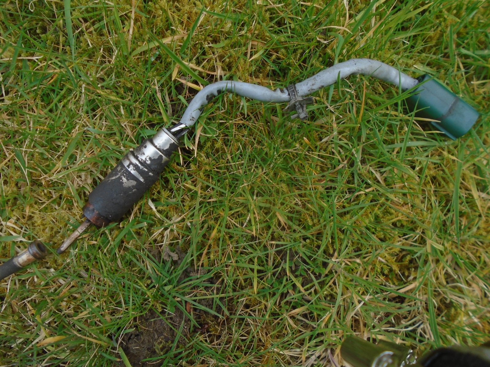

Doesn't noticably affect the running of the Bargain Basement Micra, but I got a new 02 sensor for about £18 delivered from ECP so I thought I might as well replace the old one. I knew it was "loose" but it was more loose than I thought.....completely detached and the hex bit left behind on the downpipe.
Exhausts I have come to the conclusion are not worth bothering about home-mechanicing wise. An absolute piece of cake relatively speaking up on a lift at the garage, but working "in the street" whether on ramps or jacking it up as high as possible and putting it on stands there is "never" enough room for it to be anything other than a PITA job.
That hasn't stopped me over the years saving the odd £50 or so doing them myself, and spending uncomfortable hours, grinding off rusty nuts whose hexagons have turned into circles, and fiddling about usually at arms length flat on your back to dismantle and reattach the pipes and unions.
So I have with the Micra a job of replacing the downstream O2 sensor. Only the most optimistic of optimists imagines that the hex bit of the O2 sensor is going to be removable "in situ". No the front downpipe...and its an overly long bit of convoluted tubing....needs to be removed. Joint number 1 after the cat is right at the front of the car. Joint number 2 is behind the engine up and over the subframe and right in the middle of the car. On a lift childs play, on ramps right at the bit where your head is beginning to be very very close to the bottom of the car more difficult. From the side....right at the extremity of an arm length.
Still almost do-able, and shopping around a downpipe is maybe only £30. Let's see what state the mounting nuts/studs/bolts are.....start at the easy ones the front. Looks like the hex is about a 15. Yes it is but only before the flakes of rust disintigrate. Try a 14....not much better. Looks like a hammering on of a 13mm or half inch hex would be the start of the dismantling nightmare, followed no doubt by grinding/hacksawing/swearing.
No just accept that a garage will charge you more for the downpipe and make a bit of profit on the part. They will also put down at least an hours labour....(quite reasonable compared to my own unspecified hours of rusty nut/bolt/stud wrestling and discomfort) but I will end up paying considerably more than £30 to get the job done, anticipating £80-£100.
I'll muse over that one but I have already decided if I do get the downpipe replaced its worth the extra at the garage. The car is just a back up, and a receptacle to be used for trips to the tip, and collecting DIY stuff so not a critical job to get done.
Currently the downstream O2 sensor is completely disconnected at the plug from the loom, and the car starts idles and runs OK.
