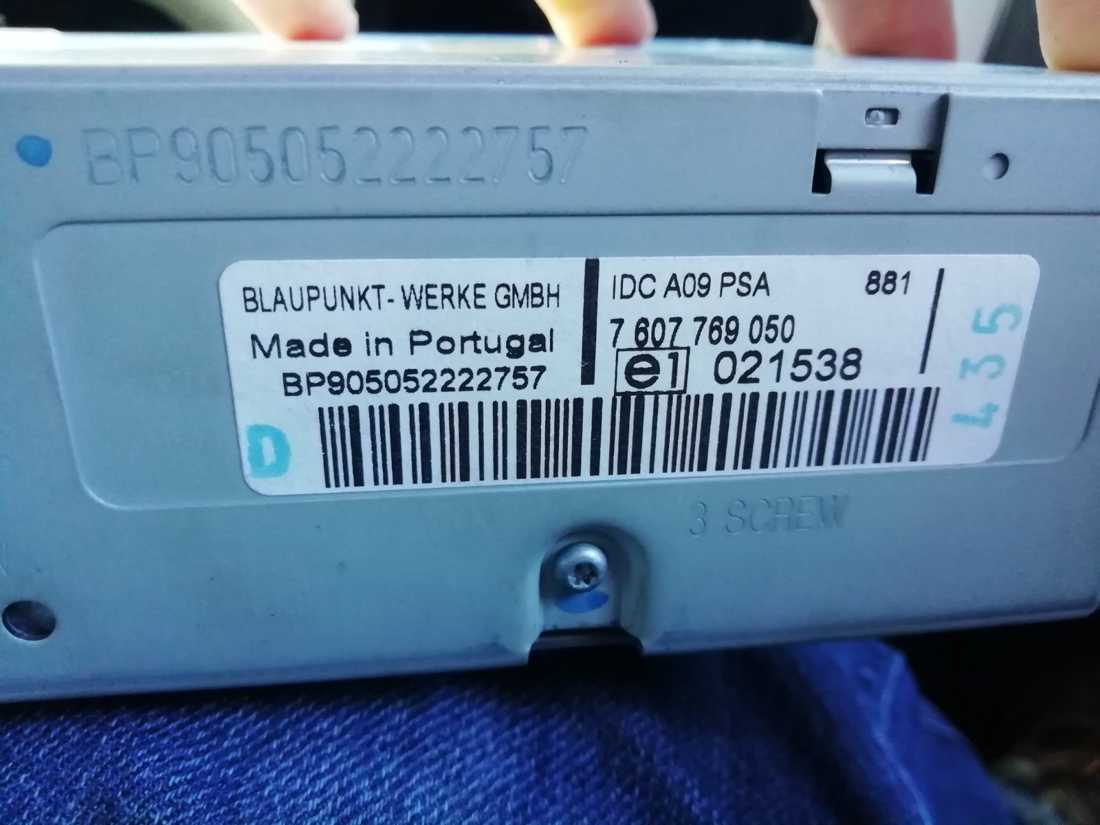

car been in storage so first chance I've had to have a look, this is the label that's on the side
- x 6947
Re: CD changer
Do you have the label on top?
C4robot
- Posts: 25
- Joined: 03 Nov 2016, 08:16
Re: CD changer
Unfortunately not, just plain metal on top
- x 6947
Re: CD changer
So here's a compatible unit for £25 (collection in Upminster) - but you may be able to contact the seller to arrange an additional PayPal payment if you can convince him to post it for you possibly?
This one will obviously have a different serial number stamped into the unit, but is the same unit.
https://www.ebay.co.uk/itm/PEUGEOT-307- ... Swol5YvrLL
