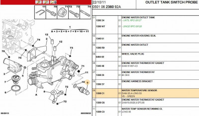

There seems to be only one coolant temp sensor on the Xsara 2.0 HDi's...
Click to enlarge This one sensor obvious feeds temp into for
- gauge
- fuel injection
- over-temp warning (STOP etc)
...previously done on earlier engines by three separate sensors on the water outlet.
So if misbehaving (sensor out-of-spec, poor contact?) this would affect a good deal of the system.
Might be worth replacing it anyway? Pt.no. 1338.C1.
Others know this engine better than I do, though.

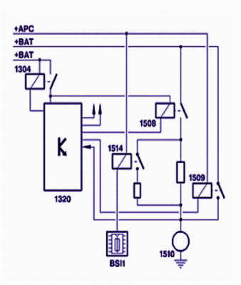

Right, on your Xsara you have 3 fan speeds. The engine ECU controls the Slow and Fast Speeds and the BSI controls the medium speed. This is the info I have on the Cooling circuit.

Here's the Outlet Tank and the water temperature sensor is number 9 on the diagram. The thermostat is number 7.
The coolant Sensor is part number: 1338C1 and costs £43.14 brand new from Citroen. inc. VAT
Click Diagram to Zoom Here is the diagram showing the Fan and the relays mentioned above:

Many thanks to those who responded to my problem.
New sensor fitted and (so far..fingers crossed) all seems good
Thanks again
Cheers
