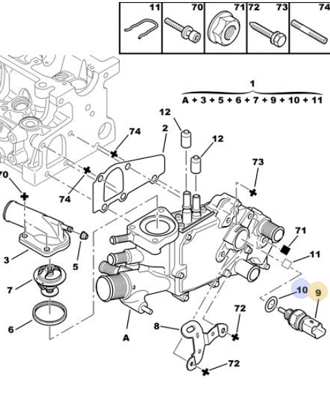

There seems to be only one coolant temp sensor on the Xsara 2.0 HDi's...
Click to enlarge This one sensor obvious feeds temp into for
- gauge
- fuel injection
- over-temp warning (STOP etc)
...previously done on earlier engines by three separate sensors on the water outlet.
So if misbehaving (sensor out-of-spec, poor contact?) this would affect a good deal of the system.
Might be worth replacing it anyway? Pt.no. 1338.C1.
Others know this engine better than I do, though.

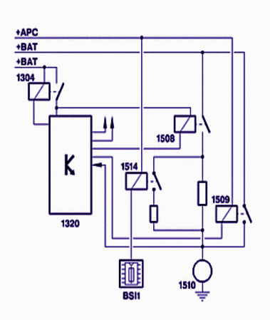

Right, on your Xsara you have 3 fan speeds. The engine ECU controls the Slow and Fast Speeds and the BSI controls the medium speed. This is the info I have on the Cooling circuit.
Calculating the fan unit speed
The engine ECU sets the fan unit speed instruction depending on the following parameters:
The fan unit is fitted with 3 functioning speeds:
+APC: + ignition on
+ BAT: Battery +
When stopping the engine, the engine ECU controls the post cooling (slow speed), if the measured engine coolant temperature is over a programmed level.

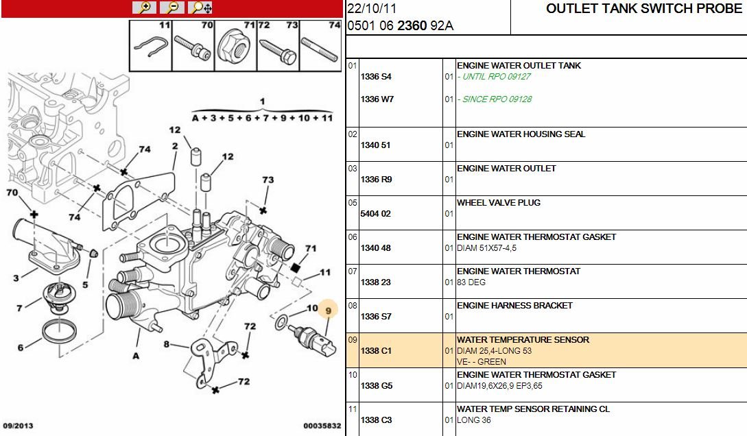

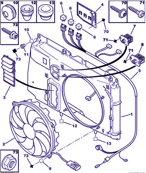

Here's the Outlet Tank and the water temperature sensor is number 9 on the diagram. The thermostat is number 7.
The coolant Sensor is part number: 1338C1 and costs £43.14 brand new from Citroen. inc. VAT
Click Diagram to Zoom Here is the diagram showing the Fan and the relays mentioned above:
- The engine ECU controls the slow speed and the fast speed
- The BSI controls the mid speed, depending on the information delivered by the engine ECU via the CAN network (engine coolant and air con circuit pressure temperature)
+APC: + ignition on
+ BAT: Battery +
| BSI | Built-in systems interface |
| 1320 | Engine ECU |
| 1304 | Injection double relay (built-in systems interface) |
| 1508 | Slow speed control relay |
| 1509 | Fast speed control relay |
| 1510 | electric cooling fan unit |
| 1514 | Medium speed control relay |
- Slow speed is obtained by supplying the cooling fan via a resistor arranged in series in the supply circuit.
- Medium speed is obtained by supplying the cooling fan via two parallel resistors on the supply circuit.
- Fast speed is obtained by supplying the cooling fan directly.
- The 2 resistors are located on the front dash, near the air-air exchanger and the fan unit.

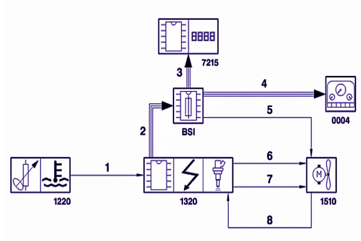

Control in relation to the engine coolant temperature
Principles
The control in relation to the engine coolant temperature is in steps . Three temperature intervals allow the fan unit to operate either in slow speed, or in mid speed, or in fast speed. The engine coolant temperature sensor, installed on the coolant outlet housing, informs the engine ECU of the temperature of the engine coolant.
Flow Chart Key:
Single arrow: Wire connection
Triple arrow: Multiplexed connection
| 0004 | Instrument panel |
| 1220 | engine coolant temperature sensor |
| 1320 | Engine ECU |
| 0049 | multifunction screen |
| No. of link | Signal | Nature of signal |
| 1 | Engine coolant temperature information | Analogue |
| 2 | Engine coolant temperature information. Information on the engine coolant temperature alert | CAN |
| 3 | Displaying of a warning message | Comfort VAN |
| 4 | Engine coolant temperature information. Information on the engine coolant temperature alert | Comfort VAN |
| 5 | Fan unit mid speed control | All or nothing |
| 6 | Control of cooling fan in slow speed | All or nothing |
| 7 | Control of cooling fan in fast speed | All or nothing |
| 8 | Cooling fan rotation information (diagnosis) | All or nothing |

Back-up mode
An engine coolant temperature sensor fault leads to the following actions:
- Operation of the cooling fan at fast speed
- Switching off of the air conditioning compressor
- Display of the warning lamp STOP and of the engine coolant temperature warning lamp on the instrument panel (according to model)
- A message is displayed on the multifunction screen
- To record a fault in the engine ECU

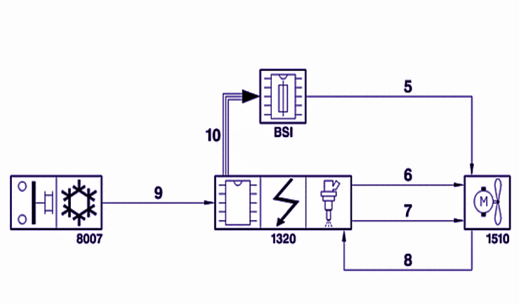

For the cooling of the condensor, the B.R.A.C function (cooling requirement of the air conditioning) integrated in the engine ECU supplies to the F.R.I.C function a speed requirement according to the pressure of the air con circuit.
The linear pressure sensor, located on the condenser, supplies a voltage proportionally to the air con circuit pressure.
Flow Chart Key:
| 8007 | Linear pressure sensor |
| 1320 | Engine ECU |
Connections
| No. of link | signal | Nature of signal |
| 9 | Air conditioning circuit pressure | Analogue |
| 10 | Air conditioning circuit pressure | CAN |

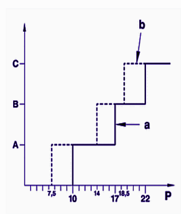

| Stage | Details |
| A | Receiving the signal of the linear pressure sensor by wire connection from the engine ECU Transmitting the refrigeration circuit pressure to the built-in systems interface from the engine ECU on CAN network |
| B | PRESSURE > 10 bars. The engine ECU controls the slow speed of the fan unit PRESSURE > 17 bars. The built-in systems interface controls the mid speed of the fan unit PRESSURE > 22 bars. The engine ECU controls the fast speed of the fan unit |
- " a": Cooling fan unit speeds triggering thresholds
- "b": Fan unit speeds untriggering limits
- A: Slow speed
- B: Average speed
- C: High speed
- P: Pressure (in bars)
A failure of the air conditioning circuit pressure sensor results in the following actions:
- Preventing the cooling compressor starting (controlled by the built-in systems interface on request of the air conditioning)
