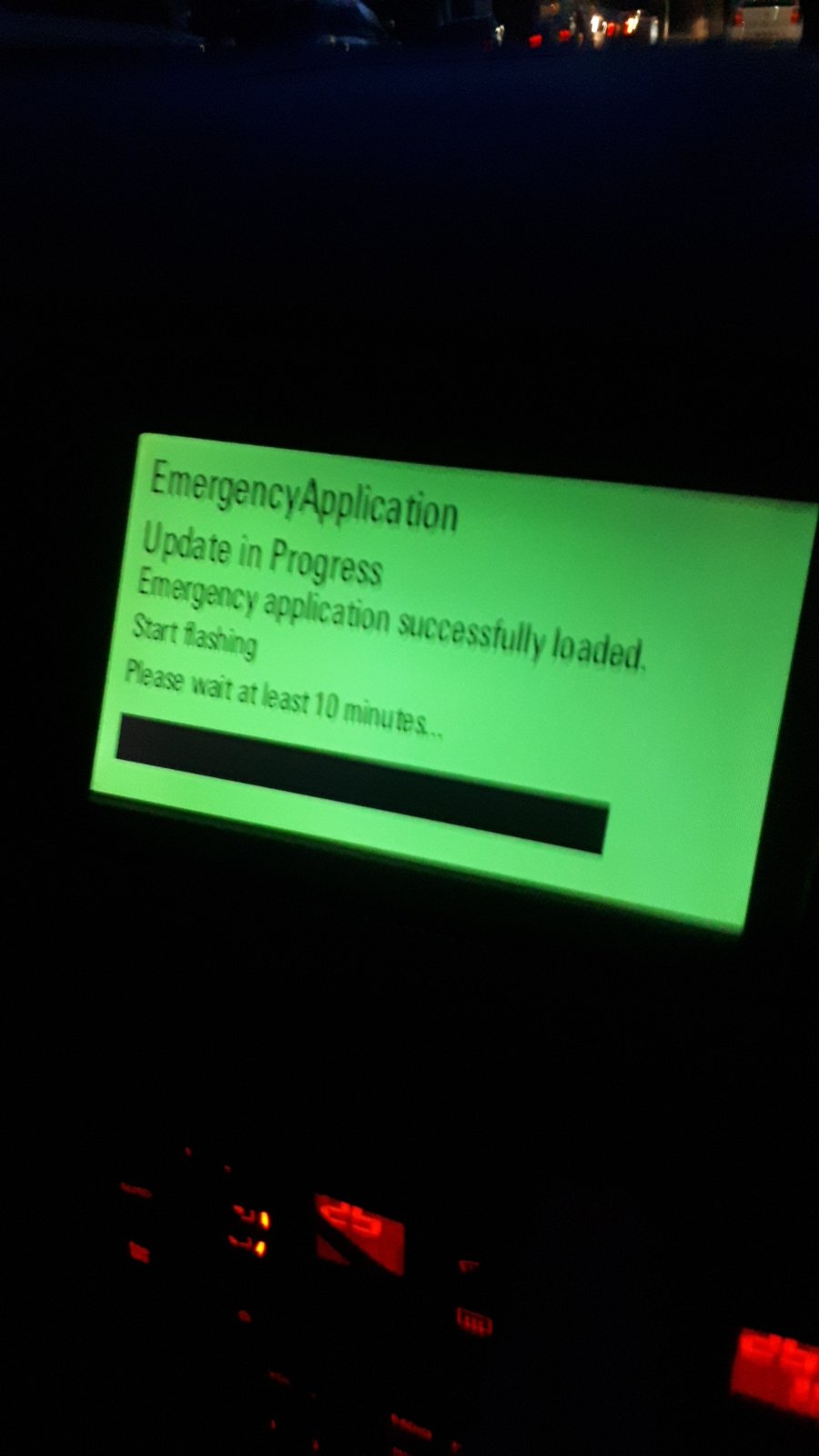

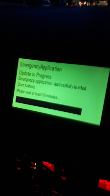

Re: MyWay / RNEG Issues
Hello guys. I hope someone here can help me. I try to updade my rneg, but I forgot CD inside in the unit and now got green screen wich says "emergency updade fault" . Is it completly dead?
- x 6948
It looks like it has loaded the recovery mode from the CD - and is now awaiting the flashing process to complete. Have you left it for the 10 minutes yet? - don't turn off or eject whilst it is doing this - until finished.
