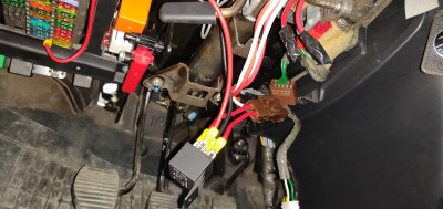

Okay so i took the car to my local mechanic and apperently no power came from the ignition(burned he said) and the fan/fan resistors were broken.
Is it possible to get it to work again with this mod? + A new fan/resistor
https://frenchcarforum.co.uk/wiki/Xanti ... dification

That modification will work in most cases without replacing the ignition switch because the current required by the relay is much less than the current required by the blower motor.
Your mechanic is wrong in saying that the resistor is broken, as a Xantia with A/C has no fan resistor, there is an electronic speed control module which is built into the fan motor housing. These can be replaced (Chinese clones of varying quality are available), or repaired by replacing the power transistors.

I think i'll give the mod a try and just buy a new fan motor (it didnt work when feeding it directly with 12v according to mechanic) they wanted me to pay 500€ for changing everything haha 😅
If that doesnt work i guess i have to buy a new ignition switch from my citroën dealer... For like 100€

The fan motor will not run with just 12V applied, it also need a control signal to the control module, or the control module bypassed.
You do not need to replace the ignition switch if only the fan/HRW contacts have failed, as the (new) relay can be driven from the normal ignition contact.

Yeah the only thing that is "broken" is the hrw and fan, just got everything i need for the mod and i'll try to post some updates when i'm done :-)
Albinoeke
Posts: 18
Joined: 15 Feb 2019, 15:47
x 2
Re: Need help with my xantia. (Mk1)
Unread post by Albinoeke »
Woilá it worked like a charm :-) everything is now working as it should 😁👍 thanks all for the help :-)
