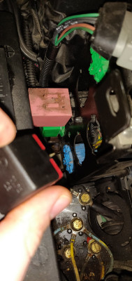

So i guess these relays i took a photo of is just spares?

The relays in the under-bonnet fuse box vary with build date and engine types, but include: A/C, ABS, front fog lights, Headlight washer timer, Diesel timing corrector, Diesel post heat, starter safely relay, and a couple of others I can't remember for now (and I don't currently have access to all the variant diagrams). It is likely that your vehicle is not fitted with one of those options.

Well there is another relay above those pictured when unplugged starts the traction control warning on the dash but i'm not sure if it has tc.

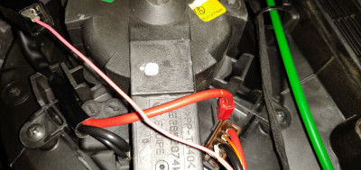

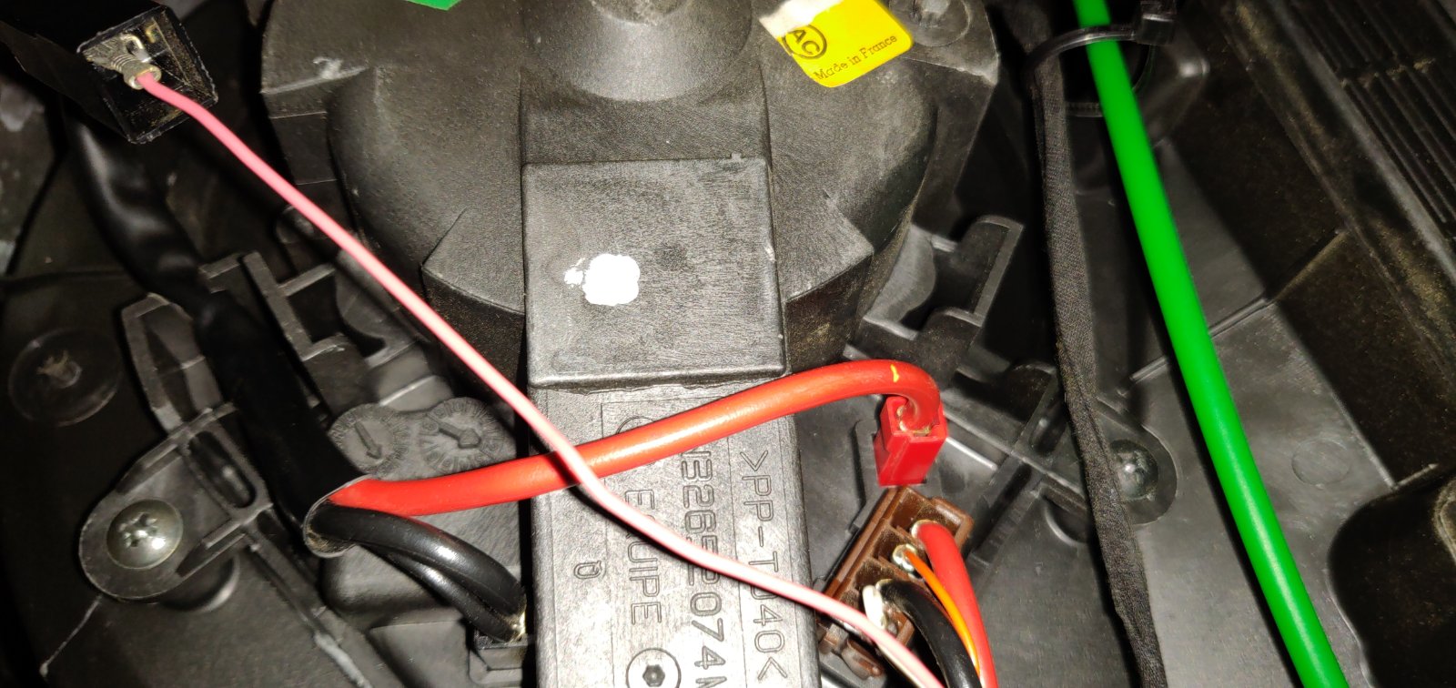

Re: Need help with my xantia. (Mk1)
I'm not very good at reading wiring diagrams and it doesnt seem to be exacly the same as mine, but i suppose the brown connector is for the controls and red(positive) black(ground) but there is another brighter red connector i'm not really sure about. (Is this for rhw?)
Also when the fan worked and would turn off it clicked pretty loud (most likely from a relay) if that helps anything.
