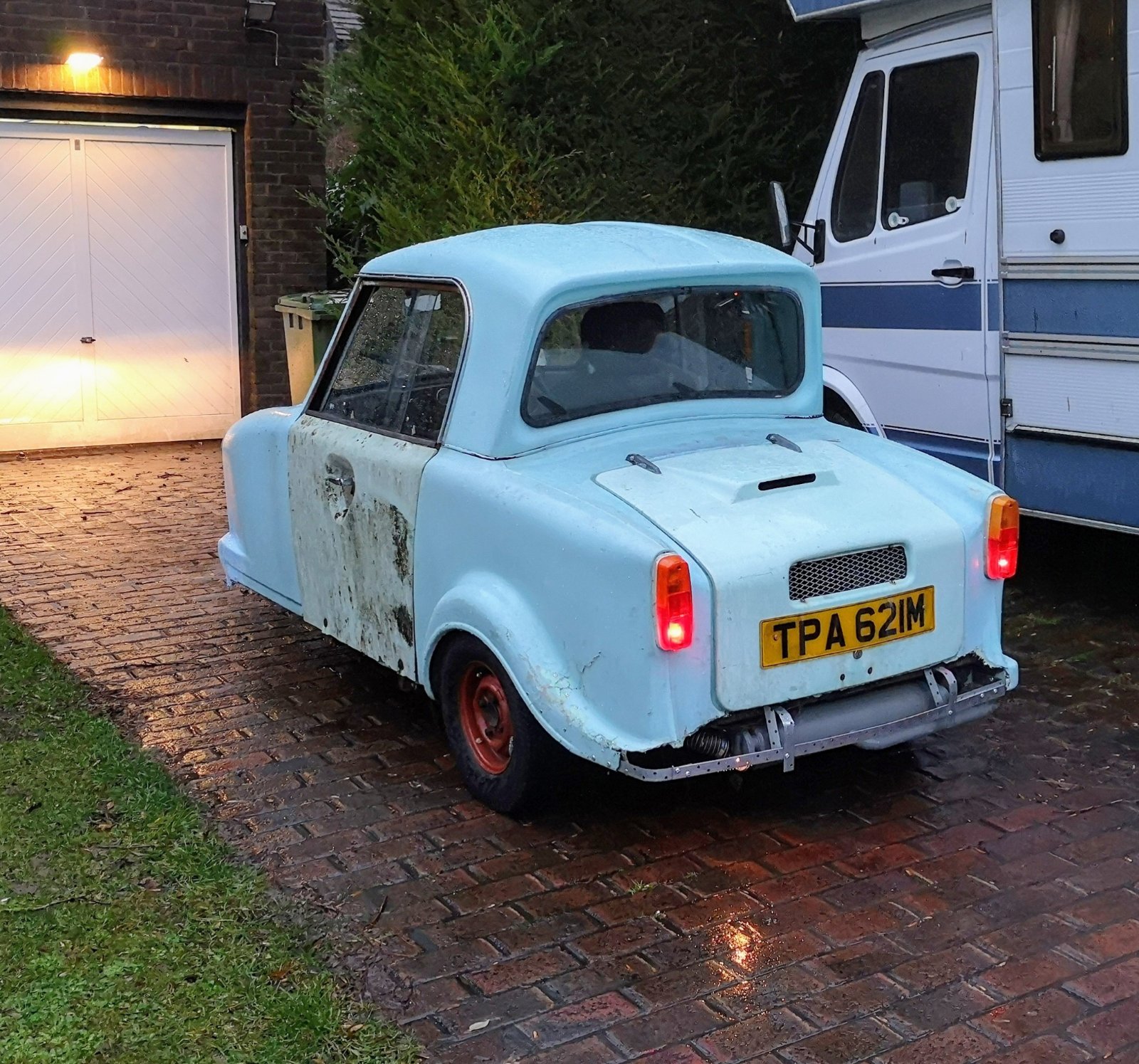

Having finally got the fuel tank installed and piped up (note to self: if you take it out again, connect the fuel line to the tank BEFORE installing it), there was only one thing left to do.
The following photos of a very damp Invacar demonstrate quite an important milestone.
This is for the first time in probably a couple of decades, running entirely on internal power and fuel. No fuel cans balanced on the engine cover, no borrowed battery, it's got a full tank of fuel and is ready to drive.
Now it's been blowing a gale and tipping it down all day here... exactly the sort of conditions you *don't* want during the first test run of an extremely small three wheeler with questionable stability and laughably poor weatherproofing. So I really should have waited until the weekend.
Yeah...we all knew that wasn't going to happen didn't we?
[YouTube]4UY4E1EYC1Y[/YouTube]
Apologies for the quality - the phone was just wedged behind the heater/choke cables and it was getting dark, so it was the best I could do.

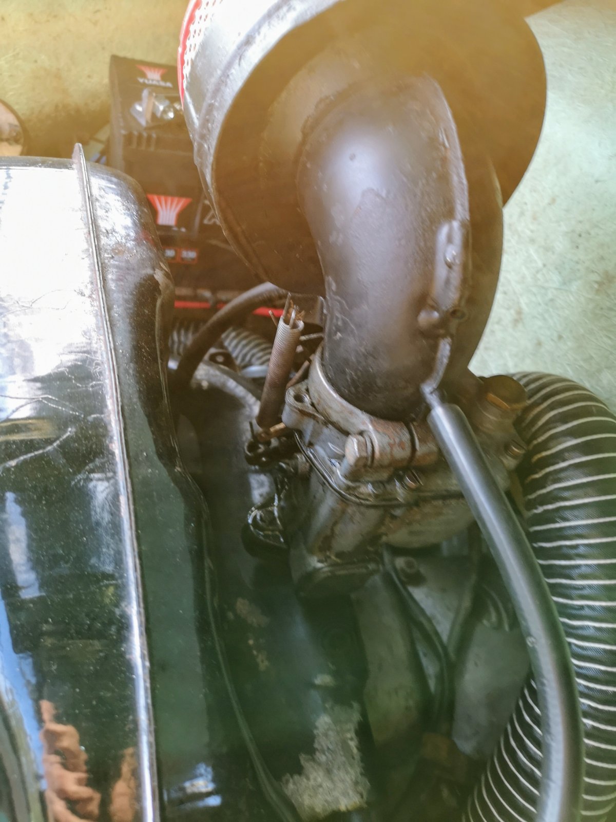

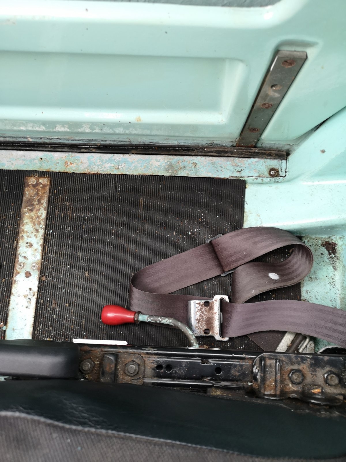

Task number one for today was to get the offside brake light working again as I noticed yesterday when I got back into the garage that it was out again. This eventually turned into a 45 minute round of chasing my own tail before re-terminating the main ground for the cluster as I should have done in the first place - which of course immediately resolved the issue and also got both sets of indicators to flash at the same rate for the first time.
Task number two was to cover up some of the bare metalwork on the rear of the car. This has wound up with the whole thing encased in duct tape for now, looks horrific, but at least there are now no sharp edges accessible. I'm sure a bunch of these cars were largely held together by gaffer tape back in the day too.
No, I'm not proud of it. It's a means to an end - I want to drive the thing, and don't want to wait until I can put aside a couple of complete afternoons with decent weather to attack it with fibreglass.
The offside front corner has had a steel band added to reinforce it, and has been similarly plastered in tape. I've also stuck a patch on the hole in the roof primarily to assist in keeping the weather out.
Speaking of keeping things in or out, I'm glad to see that the lock on the front service cover has freed up after a couple of months of regularly dosing it with penetrating fluid.
Nice the way stuff seems to keep coming back to life.
With this all done it was time to go for today's test run. After a little noodling around our estate again I decided that it was time to try the higher speed run. No horrors to report. Managed to get up to just under 50mph before having to brake for the roundabout at the bottom of the hill. On the way back progress was slowed a bit, but still got up to 40 or thereabouts. The only slightly unnerving aspect was that she briefly decided not to give me any power when I intitally went to pull onto the roundabout coming back - a fraction of a second's delay and audible pop back through the carb and she was off again. I've notice this happen a few times on roughly half throttle. Guessing there's still a bit of crud floating around in the carb.

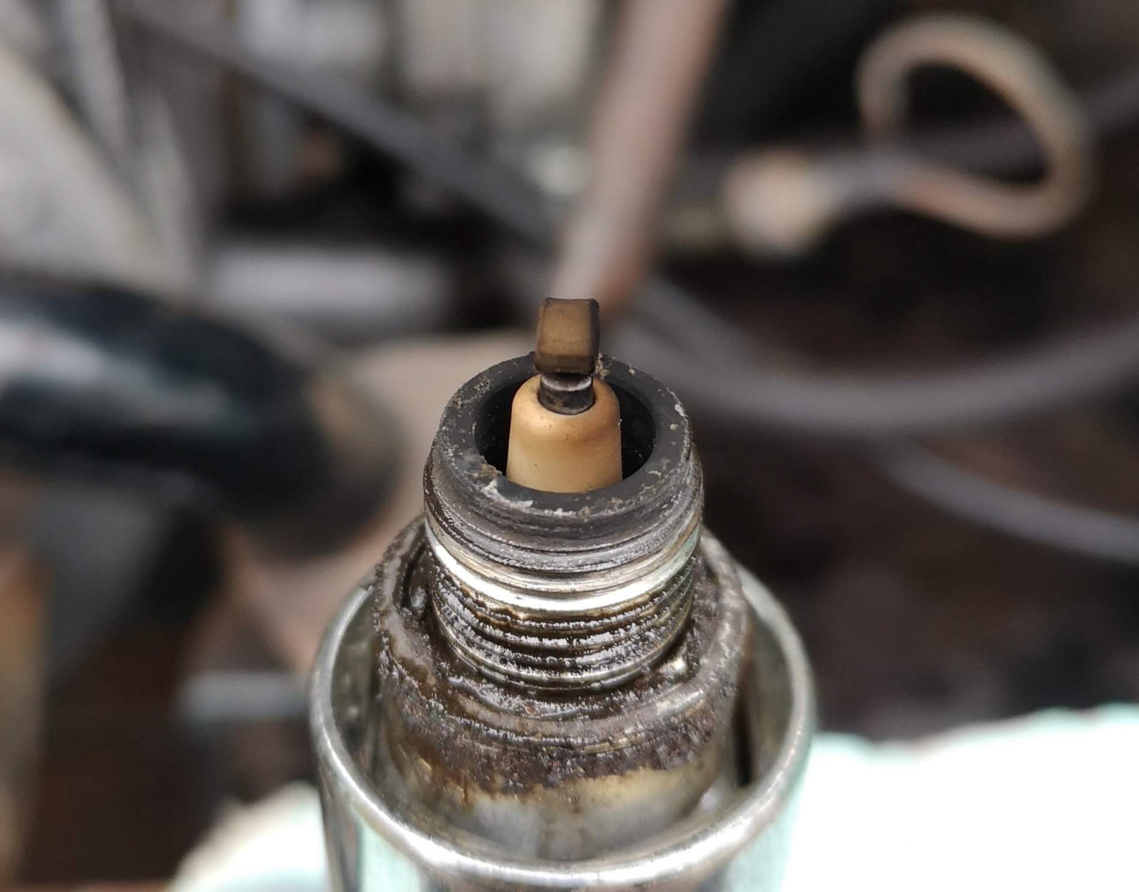

On arriving back from that run (wanting to give thigns a check over given it was the first time she had exceeded 30mph in quite a while), there was quite an odd "hot" smell - which I reckon was coming from the paint on the silencer after a bit of checking. The popping back through the carb I reckon is the reason that the carb itself was damp with fuel.
The carb being cold I think was the only reason this hadn't evaporated pretty much as soon as it had ended up there. I'll keep an eye on this. As soon as an stopped the engine and the carb started to warm up it evaporated. This seems to be something these cars are quite prone to. I did note the air cleaner wasn't tightly bolted on, I've corrected that now.
I then went about a little further local testing, getting a little more used to the controls meant that a certain degree of mild hooning may have taken place. It's a long while since I was last in a Reliant, but to my mind this definitely feels less tippy when you throw it into a corner or roundabout.
I did attempt to get some video footage of the test drives - but managed an epic fail today on a video front. Attempt number one went just fine until the first roundabout was taken at any speed...at which point the phone fell out of where I'd wedged it. Attempt number two would have been fine if the phone hadn't wound up pointed mostly at the ceiling. I'm going to try to dig out the Not-A-Go-Pro tomorrow and use that instead as it at least has some proper options to secure it to the car. If you guys want me to upload the video I do have just let me know...You can kind of see what's going on and have the audio to go with it.

When I got back from that run, with an even five miles on the clock I decided to check the condition of the plugs just to give me an idea how the engine was running. It's worth noting that the one in the offside cylinder has always had a history of flooding quite regularly on startup, and had always been sooty when the car had just been idling on the driveway. This is how it looked today.
Here's the partner from the other cylinder.
Not bad at all I reckon, though obviously it's hard to tell too much from so few miles. No obviously catastrophic oil contamination or anything like that at least.

[] Gearchange linkage fell off!
As I limped into the driveway on one-and-a-bit cylinders due to the fuel starvation issues, I applied the handbrake then suddenly found that my right hand couldn't find the gear lever for some reason.
Oh. That doesn't look right! Sure enough, pulling the rear service hatch out and standing on my head showed that the connection between the lever and the actual gear selector had come apart. Nice and "easy" to get at...
You may recall when I took this out of KP I was unable to extract the split pin from this linkage, so I'd put it together with a bolt and lock nut. Obviously this isn't up to dealing with the vibration etc, so I'll need to find a better solution. In the meantime I'll make up a new locknut and apply some threadlock to hopefully keep things together in the meantime. A long enough bolt to fit this position definitely needs to remain in the vehicle toolkit though!
It was nice to see that the pulleys do seem to be cleaning themselves up quite nicely though simply through a bit of use, and that the belt tension seemed to have remained exactly as I left it when I adjusted it.
While there's still some oxide left there visible, the surface itself feels far, far smoother than it used to. I did wonder if I should put more work into cleaning this lot up - but given that the drive system seems to be generally behaving itself I'm inclined to leave it alone for now.
